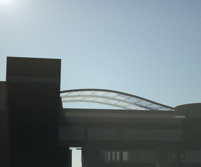

face_off
Posts: 15813
Location: Adelaide, Australia
Whilst the above method gets fog - I'm not sure how to get sun rays. Tried importing a sphere with reversed normals and that made no difference. Have tried scaling the scene, using diff kernels, brighter sun, etc, and that didn't help. So not sure what I am doing wrong. Can't get sun rays in the Poser plugin either - so there is a problem with my workflow somewhere.
Paul
face_off
Posts: 15813
I found my workflow issue. The correct procedure is:
1) Load scene into ArchiCAD
2) Set camera viewcone to about 20 or 30 (to give yourself some space for the volumetric cube)
3) Set OctaneRender for ArchiCAD plugin. Open Viewport, start rendering, click A/F and select a focus point (this will turn OFF autofocus)
4) Go to Axo view, zoom out, add Object -> Basic Shapes -> Cube
5) Enlarge cube to cover your entire scene, except the camera. Camera must NOT be be inside the cube
6) Change the material of the cube to something not used elsewhere in the scene
7) Can back to General Perspective (cube should be blocking the view)
8) In the plugin, Rendering Tab -> Refresh
9) In ArchiCAD, unselect and reselect the cube (the new material should now be in the plugin Materials tab)
10) Change cube material to specular, reflection 0, index 1, smooth disabled, roughness 0, fake_shadows enabled, medium scattering (scattering 1, absorption 0, phase 0.5, scale 0.01).
11) Change kernel to directlighting
12) Rotate camera and move sun until you get the effect!
IMPORTANT NOTE: If you set the scene scale (Configuration) to 1, the a scattering scale of about 0.01 is used). But it is easier to scale the scene down (0.1), then you can more easily tune the scattering. Remember to adjust the rayepsilon if you scale the scene.
Increase the scattering scale to get more effort. A setting of 1 will be like a snowstorm!
Also, IMO a cube seems to work better than a sphere as the volumetric geometry.
And, no need to reverse the normals of the volumetric cube.
And, only works well the Directlighting kernel.
The effort works better inside (where there are darker shadows) than out.
No need to use blender or any other external app - all done within ArchiCAD!
Paul

face_off
Posts: 15813
And another sample. Again, directlighting, although path tracing and PMC work - but they spread the rays out a bit more and the scale requires more precision when setting.
