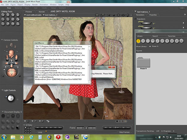

WindowsError: [Error -529697949] Windows Error 0xE06D7363
Sometimes I receive the above message when Poser is transferring the scene to Octane.
Try another scene and I get this message
Cuda error mesh parameter error
I'm using a Geforce GTX660 Graphics card.
I haven't seen this error before. Can you provide a screenshot and the octaneplugin.log file for when this happens pls? It is in your Poser Temp folder.
The DEMO version of the plugin is many versions behind the current stable release of the plugin, and it unfortunately does not handle irregularly constructed geometry well (ie. partially uv mapped props - which give this error). The current stable release should load this geometry correctly. I will update the DEMO version of the plugin to be aligned with the current stable release in the next few weeks to address this.

File "C:\Program Files\Smith Micro\Poser Pro 2012\Runtime\Python\addons\OctaneRender for Poser\OctanePlugin.py", line 9180, in ShowOctaneOptionsWindow
File "C:\Program Files\Smith Micro\Poser Pro 2012\Runtime\Python\addons\OctaneRender for Poser\OctanePlugin.py", line 6639, in Init
File "C:\Program Files\Smith Micro\Poser Pro 2012\Runtime\Python\addons\OctaneRender for Poser\OctanePlugin.py", line 7899, in refreshScene
File "C:\Program Files\Smith Micro\Poser Pro 2012\Runtime\Python\addons\OctaneRender for Poser\OctanePlugin.py", line 8595, in copyMeshToOctane
File "C:\Program Files\Smith Micro\Poser Pro 2012\Runtime\Python\addons\OctaneRender for Poser\OctanePlugin.py", line 8081, in refreshMaterials
Couldn't locate Poser Temp file but this is a cut and paste of one of the messages

I dropped 2 figures into a scene to show you the error message. I appreciate what you say about this version being a long way behind the current stable plugin and will wait until this one is improved and then try again.
badger6877
Posts: 8
Joined: Sat Mar 16, 2013 7:04 pm
This might be clearer.
I did some more research into this error, and it is produced when the Poser python interpreter cannot open a DLL. So either a PoserPython or Octane plug DLL has not been installed correctly . May I suggest reinstalling Poser SR3.1 and the plugin to rectify this error.
The Cuda mesh error will be being caused by one of the props in your scene. If you send me the octaneplugin.log file (in the Poser Temp directory -> Poser->Edit->General Preferences->Misc to find this locn) after a failed load, I'll let you know which prop caused the problem.
