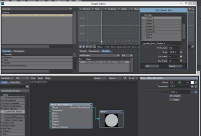

juanjgon
Posts: 8867
Location: Spain
gordonrobb wrote:Took the plunge and bought the bundle. So far it's great.
The attached is an object I had set up in LW with image maps etc. When I export it as an OBJ, and load it in the standalone app, after a bit of jiggery pokery, this is the result. The images map to the UVs just fine. However, when I try to set it up in LW, I can't find anyway to assign an image where the image uses the right UV. Any ideas about what I could be doing wrong?
And here's a daylight animatin too.
http://www.youtube.com/watch?v=Ki6wx8Nf ... e=youtu.be
Do you have more the one UV maps in the object?, octane doesn't support more than one UV map and i a vertex has more than one, plugin select the first one ... if you want to send to me the scene I can test it and tell you what may be the problem.
-Juanjo

juanjgon
Posts: 8867
Location: Spain
gristle wrote:You cannot keyframe disable though?
No, sorry :( ... a workaround may be link all opacity channels in the object's materials to a common paramterer to control all of them with only one setting. You can use the "E" envolpe editor and for example the set driven key modifier. In this example I link the opacity to a X position of a Null object ... if you move the object X position between 0.0 and 1.0 you can control the opactity of all materials at one time (I think that this is not going to work in realtime in the IPR, but if you reload scene or in final render should work fine)
-Juanjo
