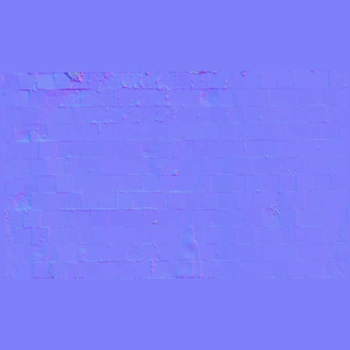

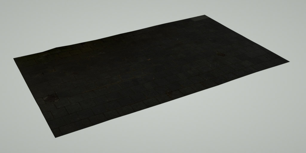

I have a normal map (generated with xNormal) and need to apply it to a mesh but it shows up very dark.
Does octane only work with world space normals or where does this problem comes from?
Any help appreciated.

Ah, I have got it.
Octane does not support 16 bit Normal Maps.
solved
