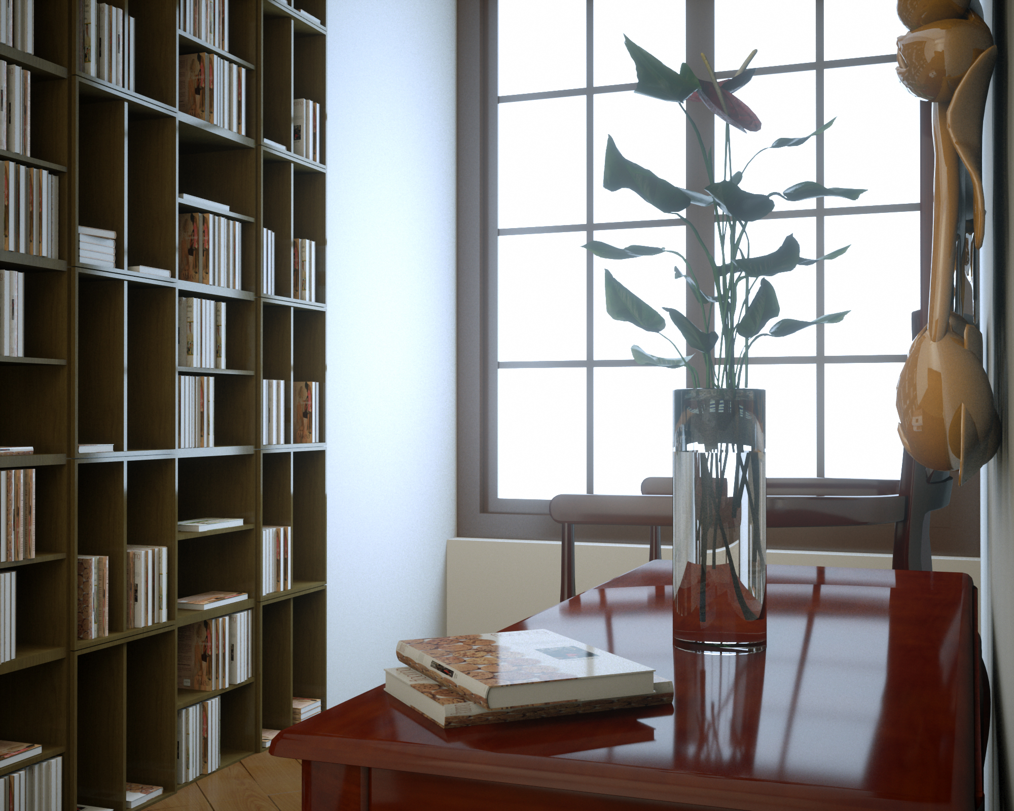

Merid, I like a lot your new images in particular the close up (i like how you placed the camera).
As Paquito says (I'm totally agree with him) "you are definitely on the right way"; but, as I told you for "another interior", at the point that you have reached you shouldn't "under stimate" how important are the details.
The two books and the vase catches immediatly the attention
- try to vary some texture for the books (at least for the two in the foreground)
- try to separate a little (I think that you have aligned them perfectly) the vase from the table. (this is useful even for all objects in the scene), it creates better "contact shadows"...this is not a my trick but it's what many peoples usually do (the same effect can be reached chamfering the edges of the geometry, this other solution is ceratinly preferred for it's visual effects (more natural) on the gemetry itself)
Keep posting
Cheers, Paolo
