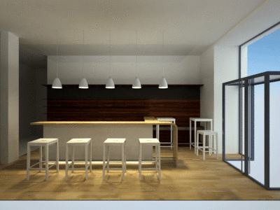

For the big OctaneLight above the Lamps that lights the cieling i unchecked visible but it`s visible, though......

hi,
its probably bug.
I never using this fake lights.
On th first look, problem of your scene is, that there is a little daylight and emitters has a lot of power. Its look like unnatural.
So try this:
-Daylight power - 1
-emitters power - max 5-20
-increase exposure in imager to brighter your image.
I hope this help you to get better and more natural result. ;)

gueoct wrote:For the big OctaneLight above the Lamps that lights the cieling i unchecked visible but it`s visible, though......
Do you use pmc here?
If so, try to increase depth.
Yes, using PMC; increased depth form 5 to 6 and... problem solved! Thanks a lot!
