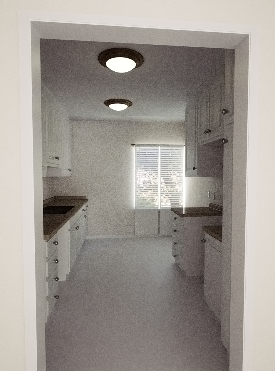

Bathroom and Kitchen cabinets are up, no appliances or sink yet--that comes soon.  Working on curtain simulations now--will update this post when I've implemented them.
I'm getting noisy renders with really basic shaders in the scene--am I missing a setting somewhere?
Attached is what I've got so far.

I've begun applying shaders, is anyone able to assist with reducing the crazy amount of noise I am getting? Render times at present: 33m or so @ current sample rate and resolution. This noise was present with just basic diffuse shaders as well.
Using OctaneRender® 1.11 standalone
Using PMC @ 2,500 samples -- not much change going higher over long periods of time.
Caustic Blur set to 1
Filter set to 1
Portals in the scene
Material values are normal (not set too high)
Rendering at 936 x 1264
One black body emission shader on two pieces of geometry (the ceiling lights) @ 256 samples.
f/1.4, ISO 100 (no grain), 1/2 second exposure (500).
No HDR, only Daylight with image plates on geometry.
Attached image is after rendering at twice the target resolution, despeckle, noise reduction and down size to target resolution--it was much much worse.
Thanks.

The floor-plan is pretty much done here and I'm getting ready to furnish. I'm going to keep pushing forward but unless someone has some pointers on noise reduction, I may have to take this particular project to another renderer OctaneRender is a pathtracer, and is simply having a heck of a time finding light sources.  I will keep this in mind for future Octane projects so I can modify my workflow to accommodate--again, I'm open to any pointers.  I would love to continue using Octane if it can be helped.  Please assist.
I have tried the following:
PMC, Direct Lighting (Diffuse, 8 bounces), Path-tracing (8 bounces).
Low ISO (100) + high exposure.
Increase light samples.
Portals in the scene.
Render at 2x resolution and resize to actual resolution in post.
De-speckle in post.
Noise reduction filters.
Additional black-body emissions with appropriate samples.
Maximum samples (this took 8+ hours).
... and combined all of the above! Still nothing.

Good news!  I am able to get the noise in Octane to a very acceptable level where I can almost completely remove it with two passes of noise reduction in Photoshop.
I sealed off my portals, increased the power of the environment so it pumps way more light into the scene. I also ended up setting the exploration_strength to max and the direct_light_importance to the minimum--samples are at max (64,000) and caustic_blur is set to max. This is of course using PMC.
The only down side is that it takes 3.5 hours with my two 660Ti's... depressing to think that two Titan cards could do the same scene in 20 or 30 minutes -.- It may be time to snag a couple of those. I can push on with the project! Thank you to those who pointed me in the right direction in the other thread.
