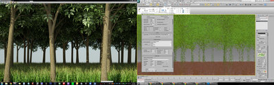

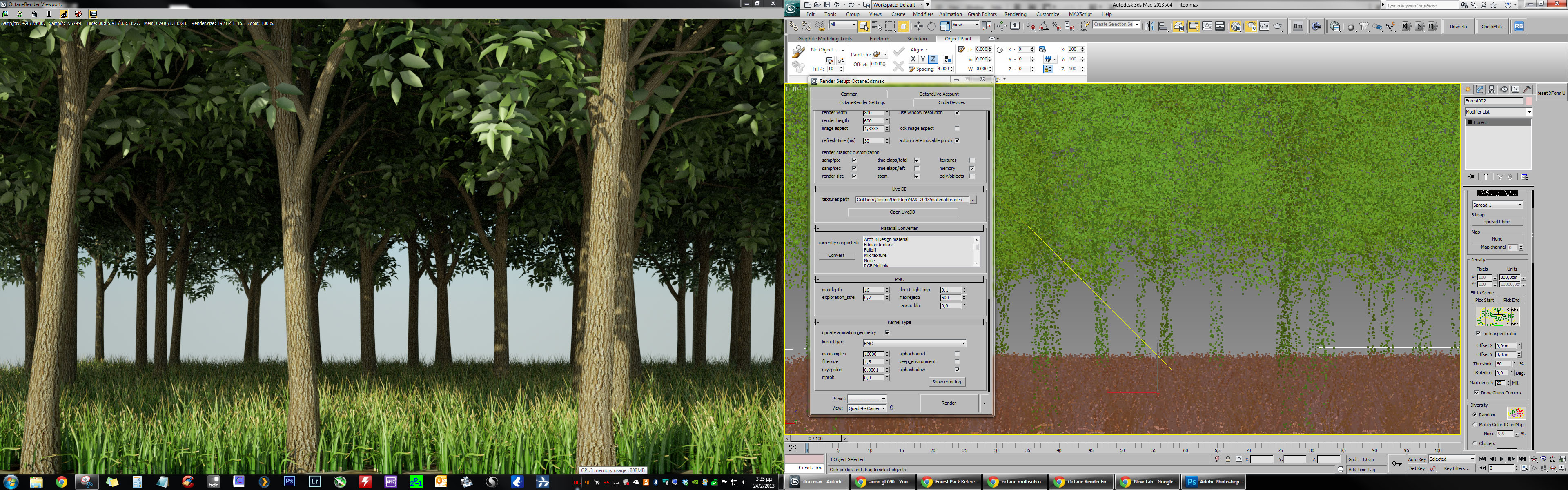

Guys!
Forest pack 4 works amazingly well with Octane! :D
2xGTX 590
Check Out the Image!!
Large Amount of trees and Grass!
