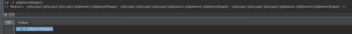

I thought about it... This approach will have a big speed impact (and memory too, but it is not so important as speed). As this string ("name" or "path") should be used as unique index in time-critical objects database - the longer the string, the slower the initial scene translation, live-update during IPR, and live-animation (especially in the case of multiple different objects at the end of the same long path, as on the simple illustration).
It would be ideal from the point of view of speed if there was a 32-bit unique identifier for each object, but Maya API does not have it...:(
You can use the special button on the Octane toolshelf which changes all names to unique.
