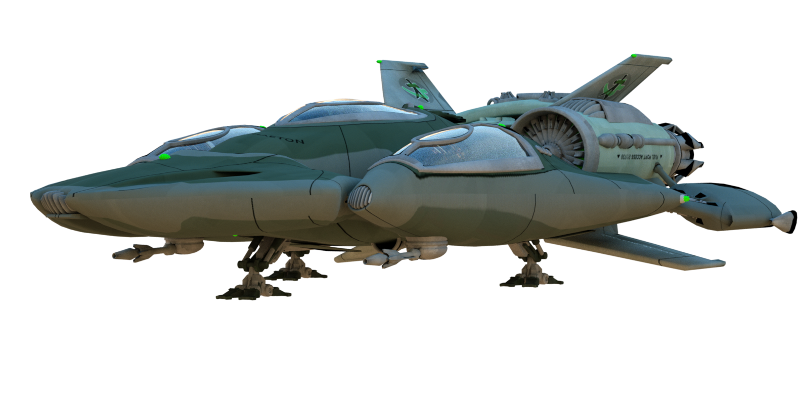

Did a test render of this ship at 600 samples. The ship render time was 2:24 Rendered with a texture environment of a landscape. Adjusted exposure to compensate for the dark image.
The results look okay, but could be better.
I don't know why some models will render out okay if they are lower quality. Large poly count models cause the system to crash. I think it's just overwhelming the video card.
Rendered at 600 samples. Notice that the glass does not look very clean. A much longer render time will be required.
The whole concept of the plugin is that is allows you to tweak and fine tune the Octane materials. You will need to do that to get the best out of the Octane renderer.
What message are you getting? Can you post a screenshot pls?
