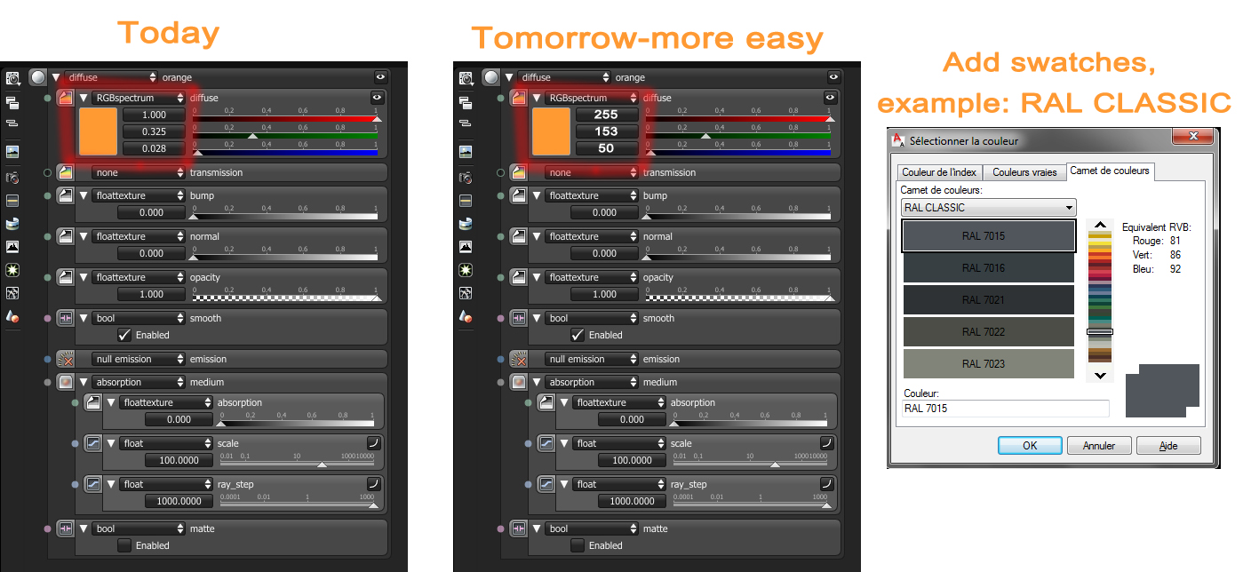

This is obviously something the exporter can't influence, since it's the UI of Octane defining how stuff is displayed in Octane. If you want to enter 0..255 numbers, just click on the color widget and use the color picker that opens.Interfaces wrote:TIG fantastic thank you, you're very good,
it works very well now.
I do not understand why not use octane numbers RGB 0, 255 in its interfaces.
Today it is not very functional
I often use the RAL CLASSIC, PANTONE ... Is it possible to add them.
THANKS
Cheers,
Marcus
- Interfaces
- Posts: 213
- Joined: Mon Jun 27, 2011 9:41 am
- Location: FRANCE
Sorry but your system is not functional, all other software uses the digit 0 -255
to get an exact color I have to gone through photoshop.
In my opinion I am not alone in this thought.
THANKS.
THANKS.

Many apps [like Sketchup] use RGB 0..255
Although you can also specify colors in several other ways.
OBJ/MTL format shows Kd as RGB values 0..1, as do other file formats like DAE, so these need to be derived from the RGB 0..255 system in the originating app.
Online guides and stuff I've found suggest that it's a simple conversion x/255 to get the 'float equivalents' 0..1.
Indeed, Sketchup's own OBJ exporter does this very thing; and its OBJ importer assuming the equivalent when converting the values back into 0..255 system.
Some apps like Octane [and I suspect Blender etc] assume that the OBJ/MTL has 'linear' RGB values, rather than 'screen' values - something I find odd since the 'standard' OBJ way seems to use 'screen', so why isn't the adjustment to 'linear' made when importing into such apps? or at least available as an option 'flag', rather than this bald and poorly documented assumption - and 'assumption' is the mother of all ****ups as we all know too well.
Thus using the standard output from apps like Sketchup Pro's native OBJ exporter the colors will look washed-out or muddy in the OCS...
That said my latest Exporter update now converts the SKP's RGB vaues into the MTL's using (x/255)**2.2 which seems to adjust them to numbers that Octane likes and will displaysin the OCS visually matching the original 'screen' RSBs in the SKP... However, as was said earlier, the OBJ/MTL will then be 'wrong' [too saturated] when imported into other apps that justifiably might expect an unadulterated MTL encoding...
