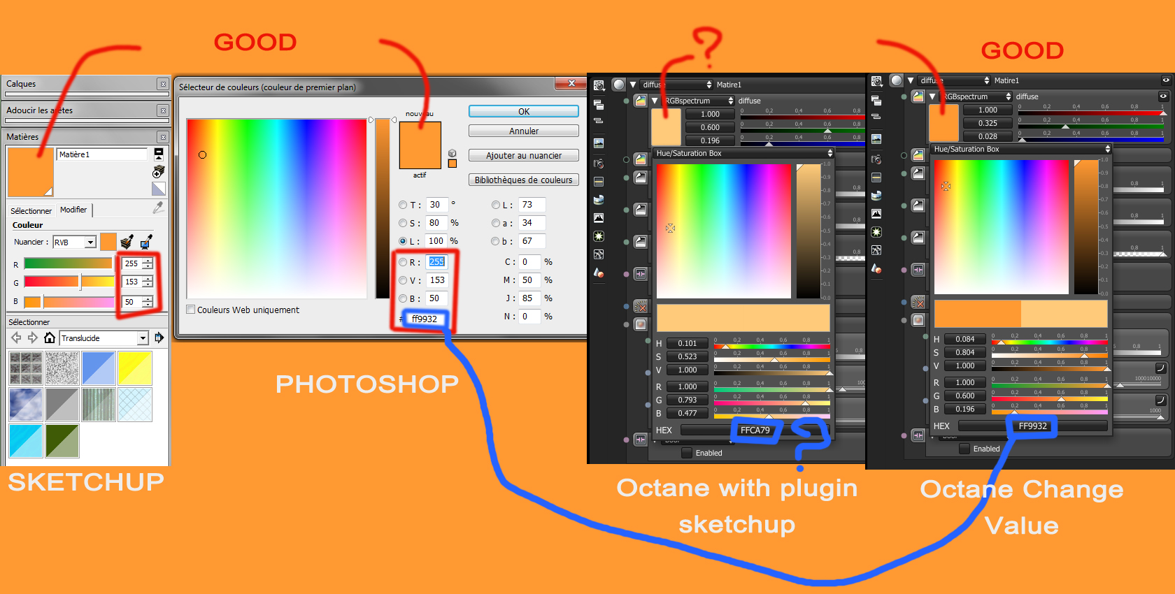

I have a problem with the color, I did a comparison of colors with Photoshop, see attached example. if you change the values ​​"HEX" as the photoshop colors is good! .
I use plugin - sketchup 8 and Octane 1.05
it just may be the version 1.05 the problem
see the topic:
http://render.otoy.com/forum/viewtopic. ... 11#p122311
THANKS
