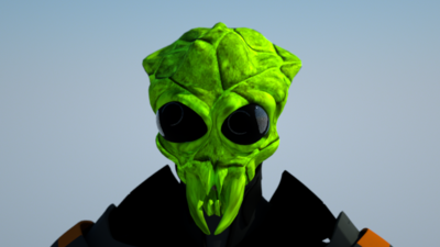

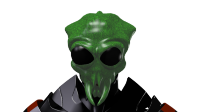

Here is what my sample looks like rendered in Poser and then in Octane. Notice the differences?

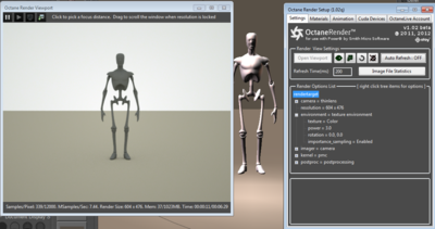

You can - simply replace the Poser default IBL map (OfficeFoyerBG_512.jpg) with your required map. You can do this in Poser (change the image map in light 1 (which is the default IBL light), or simply change it in Octane (under environment->texture environment).I would like to see an HDR for this plug in that is a basic white lighted background. Can I make one and replace the load up texture to that?
You can put a pure color into the "environment texture" too - simply change the "texture" pin to RGBspectrum (see below). If give a flat result though.
Which is Poser and which is Octane?Here is what my sample looks like rendered in Poser and then in Octane. Notice the differences?
The dark one on top is Poser.

Also, regarding the Poser version Octane render comparison....
The alien skin is clearly scaled in the Poser version, but not the Octane version.
Also, the reflections are quite different - because the Poser render has a strong lightsource above the camera, whereas the Octane version is just sunlight (or a greyscale environment texture)? To match them up, run the "Create Emitters from Lights" script - which will convert the "above the camera" Poser light to an emitter geometry.
