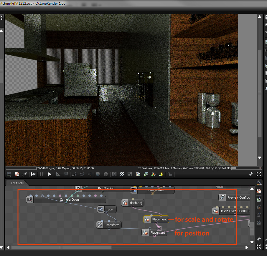

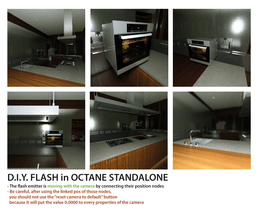

you can link an emitter together with a camera like this...
Fake flash effect
Fake flash effect
this is the setting
Fake flash setting
Fake flash setting
enjoy ;)

Cool so the feature is already in Octane like it was promised. :D
Please proceed...nothing to see here anymore..
