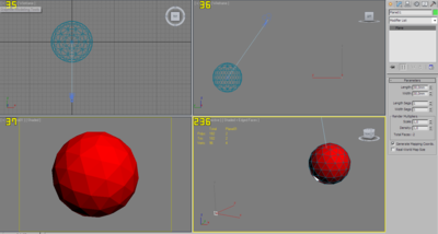

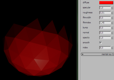

Simple scene. Camera, light plane, and NoSmooth GeoSphere. Red glossy material with IOR=2.

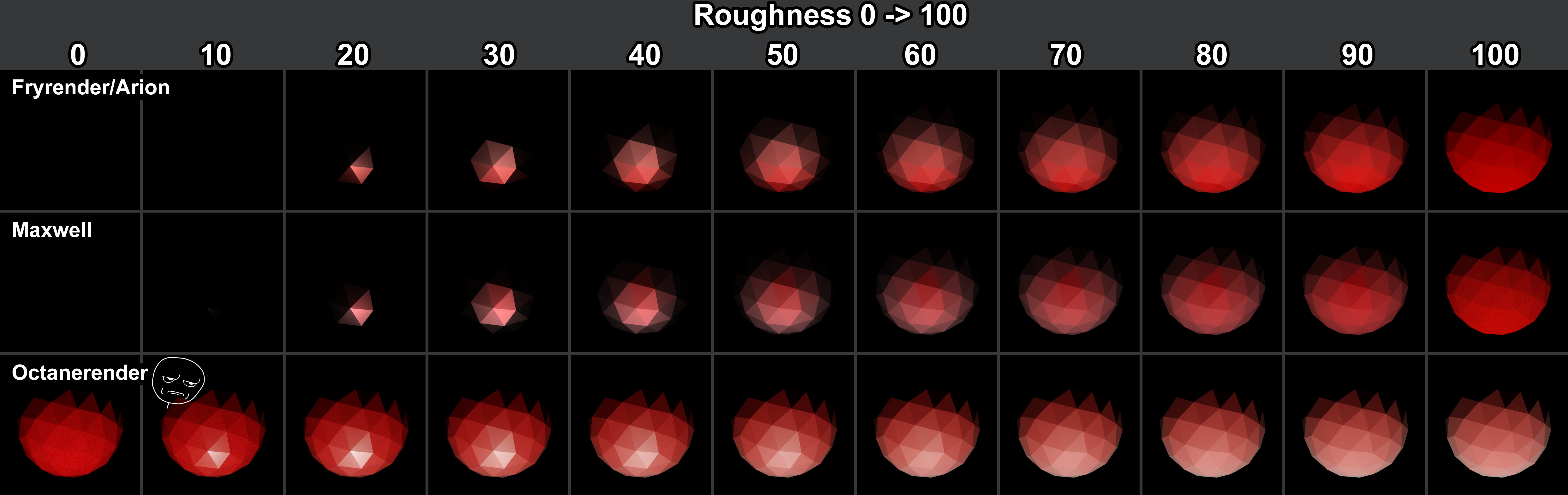

When the rounghless is close to zero, the ball should reflect much less than it is in octanerender.
Image Image Image
It looks like Biased Vray

I have red color on the "diffuse" parameter in glossy shader. But the thing is that i need red color. Maxwell and Fry materials have the same red color. I make materials as similar as possible, but result in octane (only) is different. It's more look like vray than unbiased.

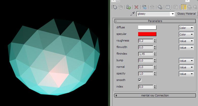

Oh, right, sorry, I absolutely forgot that the "specular" can be a RGBspectrum. In this case, all rendered correctly.

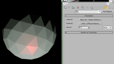

The only strange moment is an emergence of blue coloring at addition of white diffuse color. If to add white diffusion color not in the same material, and through a separate material by mix, blue coloring isn't present.
