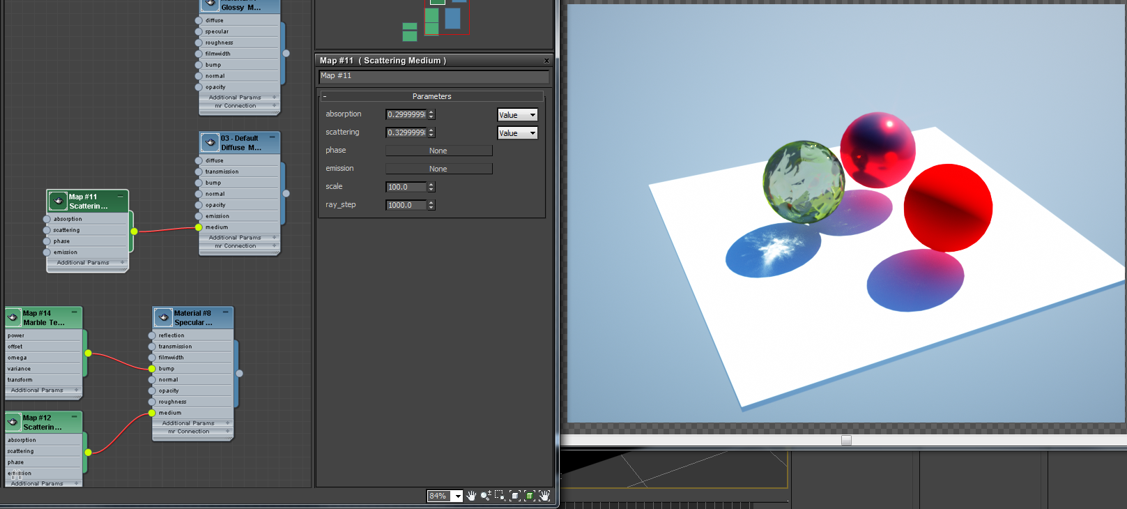

Hi Guys, I noticed while testing settings that there seems to be a problem with the diffuse subsurface scattering. No matter what setting I use, I have no effect. For not I can substitute with the specular subsurface scatter but I think this might be a pretty big error. Let me know if there is anything else I should try. I have included the settings for the medium node in the screencapture.
Cheers
Cheers
Intel Core i7 CPU 6850K @ 3.60GHz 128.0 GB Ram / Win 10 64 bit / 1x GeForce RTX 3080
Did you try to set white transmission and black diffuse?Draydin_r wrote:Hi Guys, I noticed while testing settings that there seems to be a problem with the diffuse subsurface scattering. No matter what setting I use, I have no effect. For not I can substitute with the specular subsurface scatter but I think this might be a pretty big error. Let me know if there is anything else I should try. I have included the settings for the medium node in the screencapture.
Cheers
Ahh, That did it! Thanks Karba, I was hoping it was something like that! I don't remember having this issue with previous versions, but now that I know what I have to look out for I can work with it.
