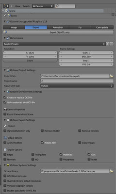

These my adjustments:
Blender 2.65/ octane 1.1

It's ok.
Before exporting a mesh, i put on mesh an "unwrap" by menu "UV/image editor.
