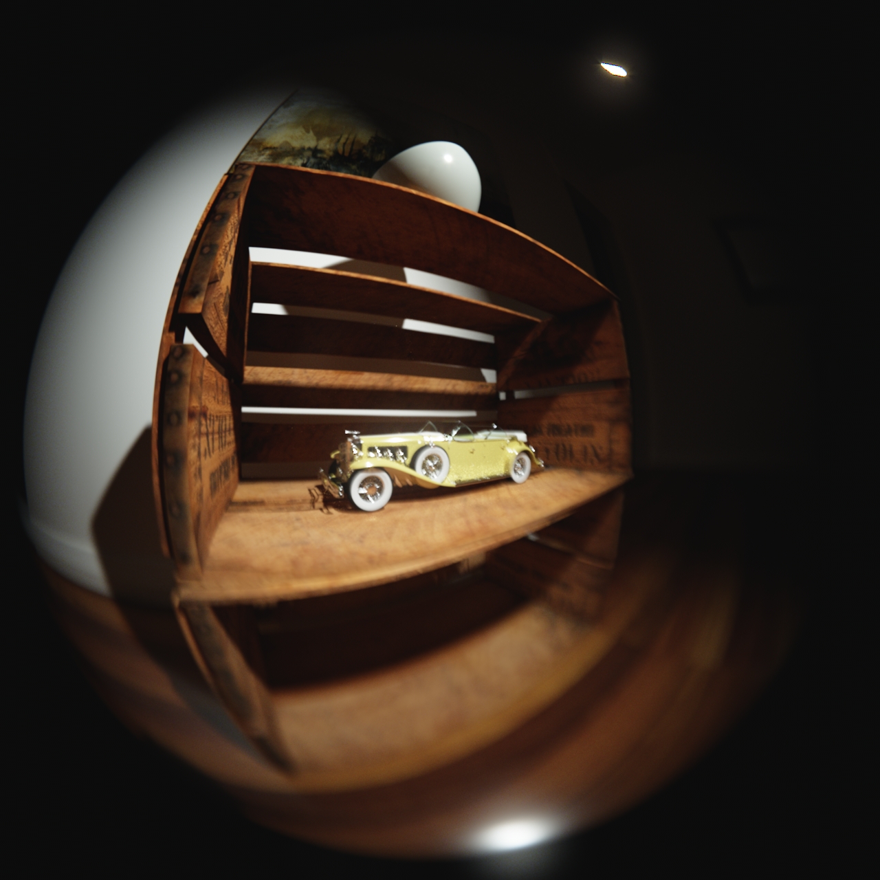

If you are feeling brave and a little experimental, you can roll your own fisheye lens too. The below image was made by doing just that :)

What do you mean by "roll your own fisheye lens" ?
Do you mean shooting the picture on a reflective sphere... or something like that ?

By 'roll your own' I mean make your own fisheye lens within Octane.
You could render a reflective sphere as you mentioned though, which can work really well too. Certainly the reflective sphere is fast compared to the refraction based lens which renders 3x slower than a 'non fisheye' render.
But if you wanted to play with the fisheye setup, I've attached a scene below. Thanks to the incredibly simple scene graph within Octane it is quite fiddly to move this setup around, but you should get the idea all the same.
Note: I attempted to upload the .ocs but the forum rejected it. I'm sure the approach is too experimental for you anyway. So go with the sphere approach as you only need to two renders 90 degrees apart to create a lightmap within something like HDRShop.

You will have to rar or zip the ocs file. If attachment not possible can you post the graph node image instead. This will be enlightening to all who view.
