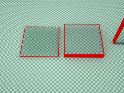

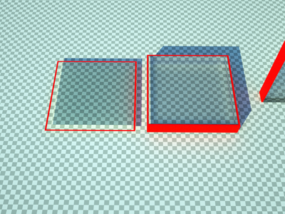

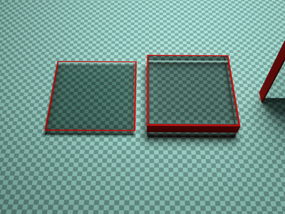

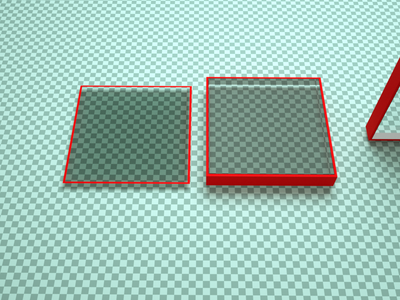

I made some further simple tests and there is something going totally wrong with specular matertials.
The images below show some tests with a plane and a cube that have a basic specular material applied (IOR 1.47).
The szene is rendered in the following combinations:
1. only one blackbody emitter, no environment.
2. daylight environment, no emitter.
3. texture environment, no emitter.
As you can see, in all of the images there is some kind of absorption. The light does not pass correctly through the glass or the glass is casting shadows that shouldn't be there.

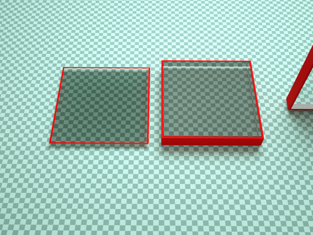

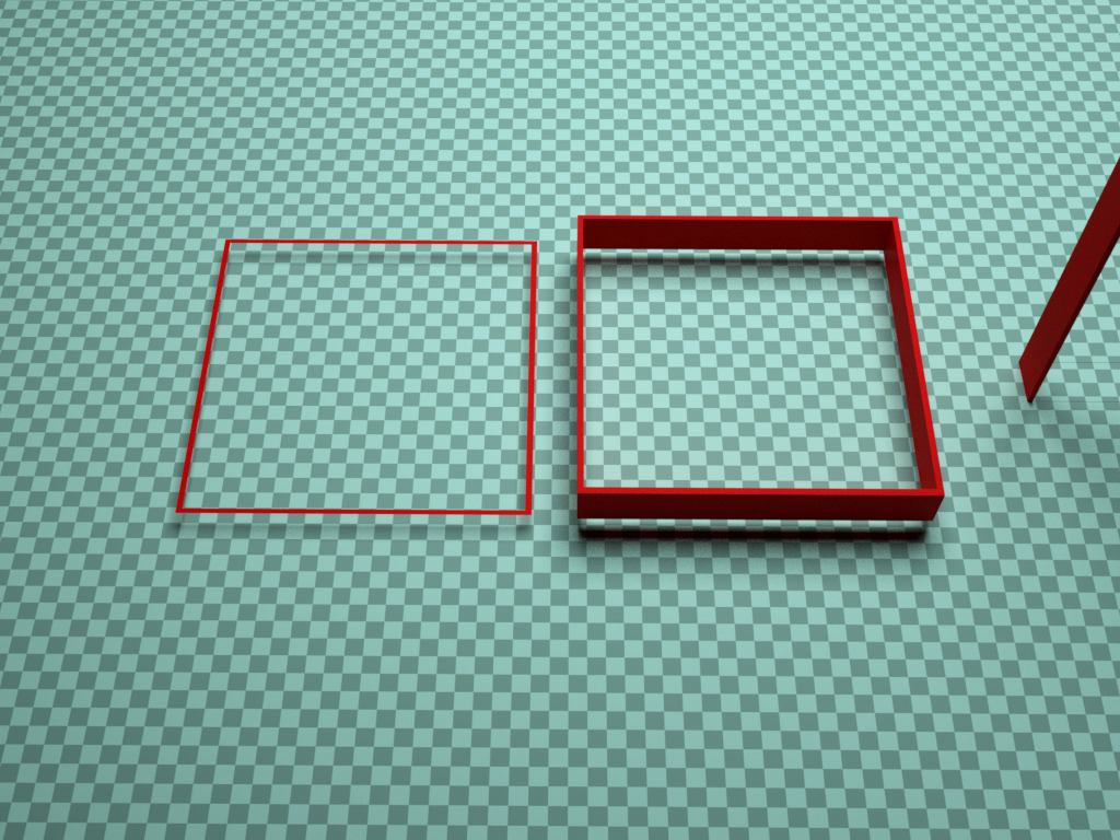

I tried PT and PMC with a maxdepth of 16 or greater. Several values for caustics blur from zero to one. Another problem is the missing color of the inside of the frame. When you compare image 1 with the image below, where the glass is set to opacity zero, you can see, that the inside of the frame should be red.
In the first image, which is exactly the same despite the opacity of the glass is set to one, the inside of the frame is rendere as if it wouldn't exist.
The frame and the glass object do not overlapp and the normals and uv maps are set correctly.
The render kernel and the values for maxdepth do not make any difference. Could someone of the octane render team take a look at this, please.
Right now, it seems to be impossible to render glass material correctly.
The test szene is attached.

Hi friscokid,
I think your main problem here will be the opacity of the emitter. At the moment making the emitter invisible will cut all indirect light (this, along with adding visibility flags and whether the direct light from the emitter should also be effected by the opacity of the emitter is something that needs to be thought through in the future).
If you increase the opacity of the emitter then this should work, also don't forget to increase the transmission to 1.0 for a completely transmissive material, and glass always has some reflection (but i'm sure you were probably just doing this to test transmission?). You shouldn't need any caustic blur.
The problem with not seeing the sides is that that the face on the inside is reflecting the floor. If you were to remove the faces around the wall so that there are just a top and bottom plane that may be more what you are after (just scale them so there is no gap around the edges).
Chris.
Chris.
Also, as another note, with the daylight system then these will always cast shadows (this is a limitation of octane). If you do this, only caustics will "get through" so adding caustic blur helps but it's not going to do what you want with the watch.
Chris.
