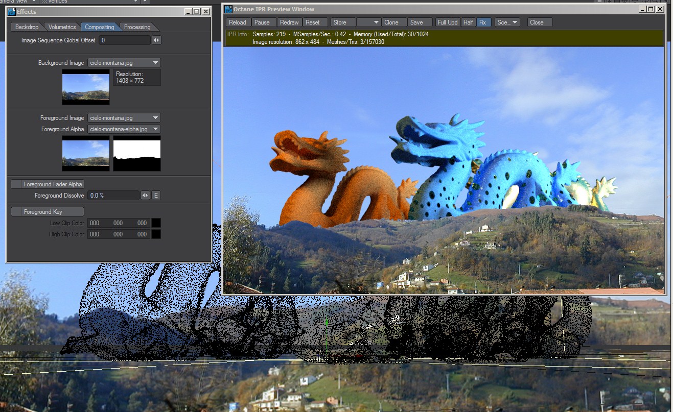

First version of the plugin is also going to support the LW compositing options for basic background/foreground compositing. Plugin use Octane image alpha channel to compose scene over background.
