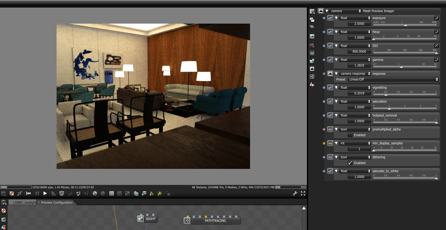

I thought they were fireflies, sorry.enealefons wrote: The spots you see are supposed to be halogen "stars" on the ceiling... it's a client idea and I agree they sould maybe be a bit less bright....

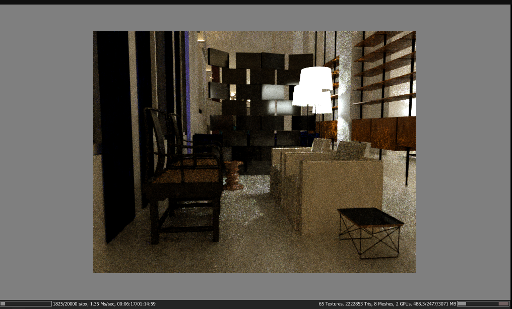

But since you have so many tiny light sources, noise (=slowness) is granted. Such scenes as the one in your first post are particularly slow to render with pathtracer algorithms. PMC is just an optimized pathtracer and the only option for this particular scene of yours. It will still be slow, though.
I don't have much experience with interiors, so maybe someone else will share their PMC techniques to battle this problem. (but you can forget about rendering 5 final shots in 5 hours)

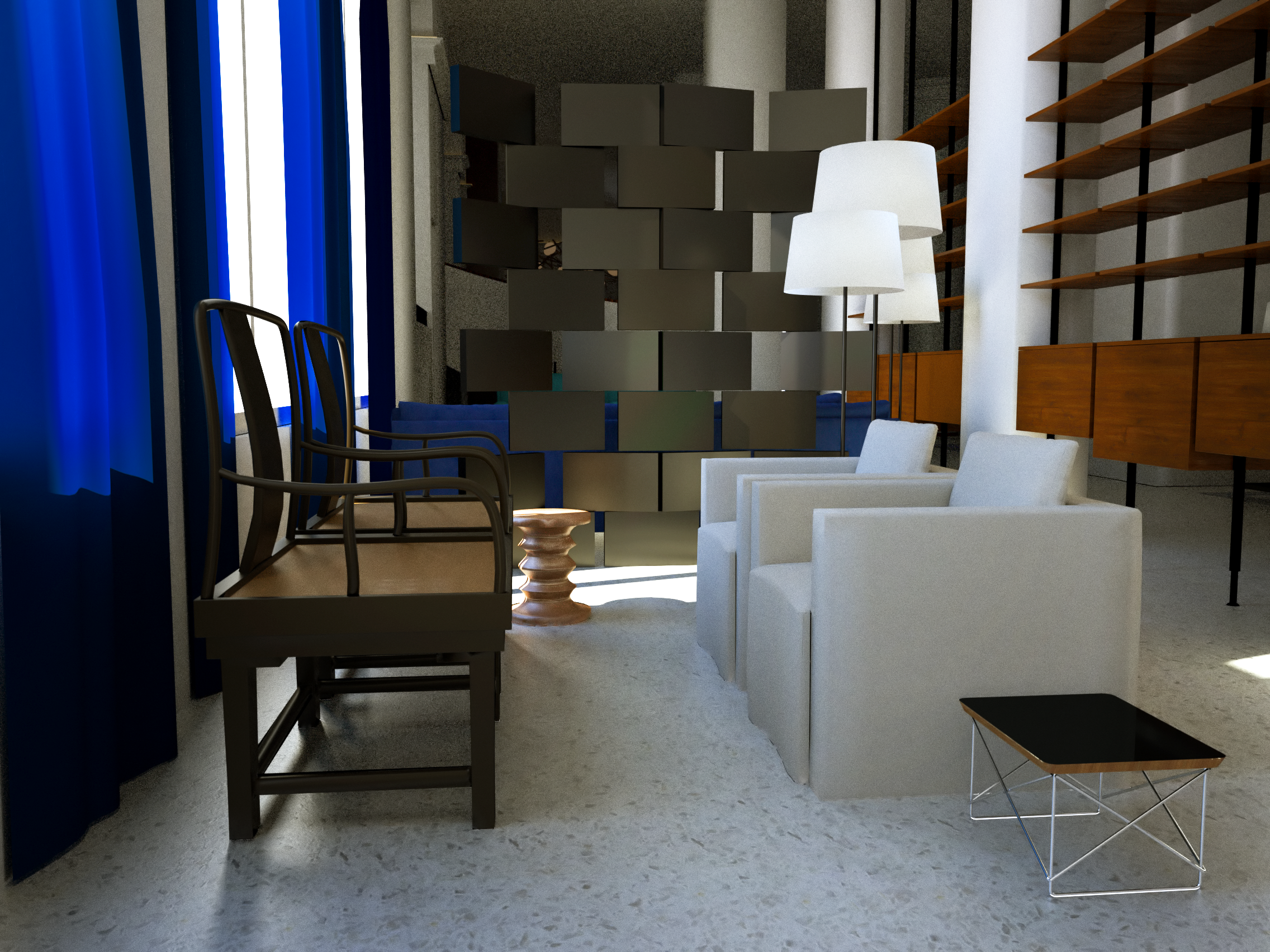

yes, you have the worst case scenario right there - tiny lights, reflective surfaces - this is a 1 render per night scene -
- other way is to break off walls try to do it in directlight - and fake your way through -
- interiors are still a pain to render, there was some news on a new render kernel optimized for interiors, hope it will help in the future
.. now you can set the samples of the emitters - what I read was to lower the samples for the lights that are too far away - should do something with the noise issue - those small lights are going to add to noise for sure

Guys, I'm so thankful for your interest and your help!
I managed to nudge forward the deadline by 10 more hours... so... the light of hope is lit up again
I am moving forward with the night shots; rendertime is still unbeareable... but I'm sort of enjoying this fast learning pushed by stress.
I have a couple of questions:
- What does sampling_rate do? with so many lights I guess tweaking it could bring to some improvements, but I don't seem to understand the logic with which it operates: all my lights are around 80, and I needed to put the lamps at 100 samples in order to have some light shine through.
- As you can see, after tweaking the light by inputing the correct WATT (e.g. 20w = 20.000), the only way to see something in my scene is to keep fstop at 1 and ISO at 800... but I smell something wrong here: in the real world one would use such a setting in almost total absence of light, and I should have plenty! I noticed however that with certain camera response presets this doesn't apply... I'm confused
- I was expecting a different behavior from the lamps: I expected the light to lit the area beneath the lamps "like spotlights"... but now it looks like it's just filling the whole environment... is this behavior normal?
Thank you SO MUCH for your support, it's really appreciated!

Question: is there a way to use Octane's tonemap on an OpenEXR without rerendering? No, right?
You indeed can't load an openEXR rendering again for tone mapping.
If you have a mix of perfect specular and diffuse surfaces, you can increase caustic blur in the kernel settings, for a start try 0.1. This will reduce the precision of caustics in the scene but it will produce a render with less noise.
I would also recommend using PMC for a scene with lots of light sources. Most of the settings can be left at the defaults. For scenes with lots of light sources increasing direct_light_importance may improve the noise.
The sample_rate parameter in light sources can be used to override the way Octane distributes calculation effort between the light sources. Octane will by default use the power emitted by the light sources as weights. If all your light sources are inside the room these can probably be left at 1.0.

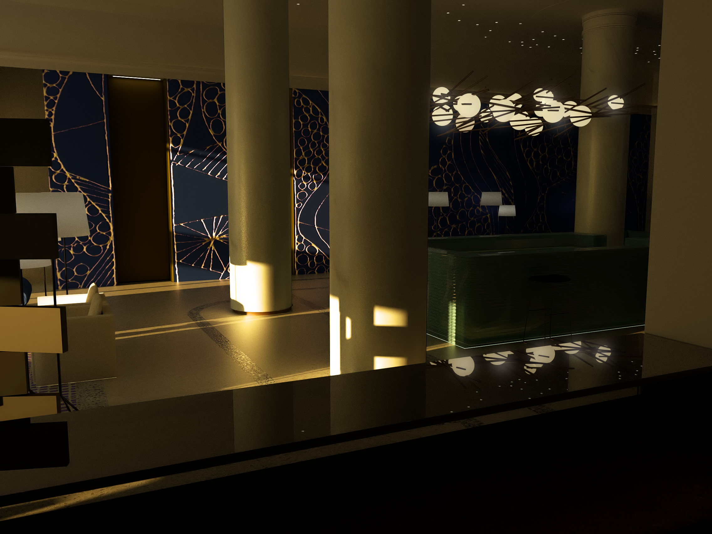

Dearest all,
Happy ending I guess!
After a full day of work I managed to come up with something acceptable.
Average Rendertime is 20 minutes, in directlight_AO, filtered with Neat Image to eliminate the noise.
However, the quest to master Octane and understand how to deal with interior nighttime renderings in acceptable rendertimes and foreseeable result is still on... I'm so thankful for this wonderful software and I'm really glad to enter this community of great render artists.
