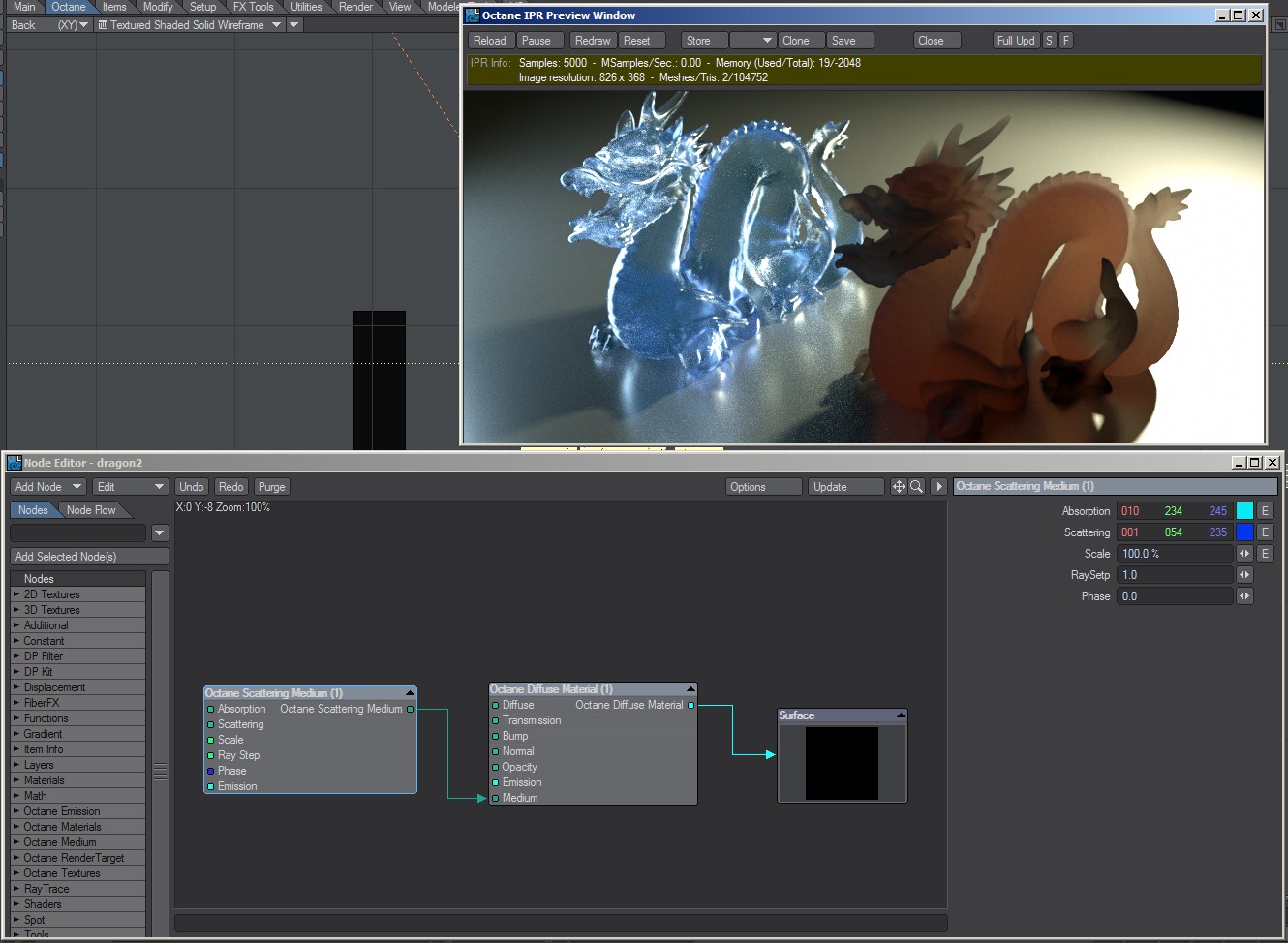

The Octane medium nodes working inside LW :)

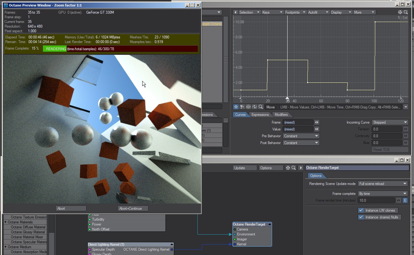

The dream for all users like myself with very tight deadlines, and one of the strong features of a unbiased rendering. Octane for Lightwave can render scenes with a time limit ... user can set the render time for each frame inside an animation, or even can set the render time using a envelope. Users can also abort the current rendering frame and continue to next one saving current image.

It could be also useful to allow to specify a total render time, and let the program refine each frame in multiple iterations, until this time is up.
This way, all frames would have the same quality... but it would need to cache on disk the current computing state of each frame to be able to resume it on each iteration.
Do you think this is possible ?
