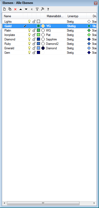

So what did i do so far? everytime my model is done, i make sure each material is on a seperate layer which is called like the material i wanna apply to. Alll the parts that will be one material (for example my gemstones) are also grouped. i also apply materials from rhinogold to it. you can see how it looks like in the pictures under this text: (Rhino Materials and RhinoShaded)

how i set layers
how i set layers

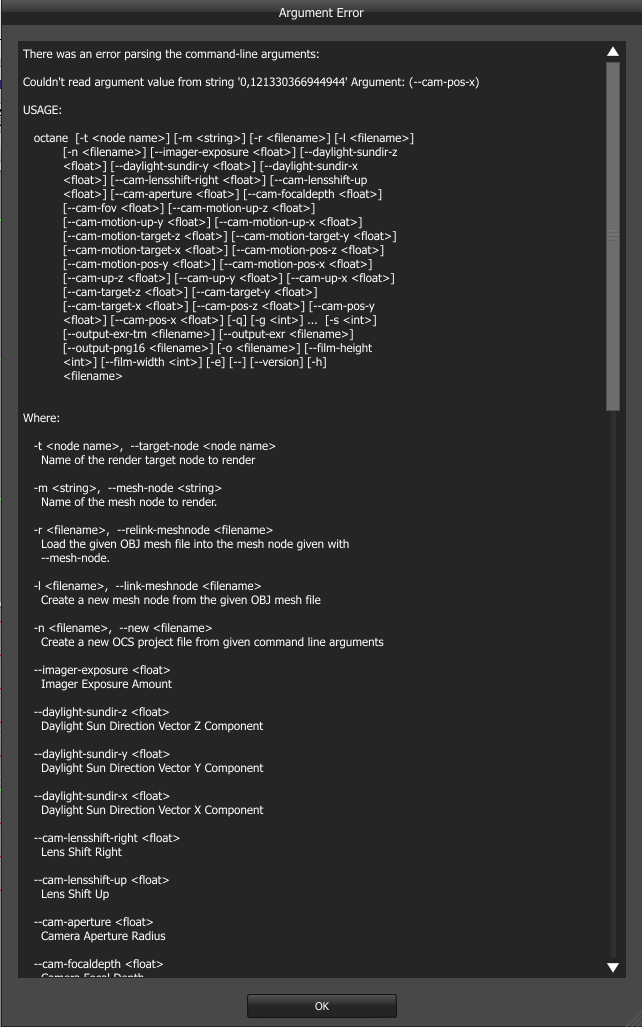

I also tried the rhino plugin from this page. (RenderOctane_A.zip 159kb)
After i installed it, i tried it. I set the octane path and so on and then i wanted to export. it made me a OBJ but when it wanted to start Octane i got that error message: (PluginError1.jpg)
Plugin error
Plugin error
i tried to drag n drop the new made OBJ to Octane but it looks exactly the same, like my own made obj - so it is anyway useless!

theres no easy way to fix this
you need to create meshes yourself and join all the meshes that use the same material _BEFORE_ you export the scene to octane
select everything in a layer and create mesh, then hide all the geometry and only meshes will remain visible in that layer, select everything in the layer again (only meshes will be selected this time) and click join
you have to repeat it for every layer and that can be time consuming on a bigger project, but it reduces number of nodes in octane to a minimum
once you converted geometry in all the layers to meshes go to 'file>export selected' and select all the meshes
