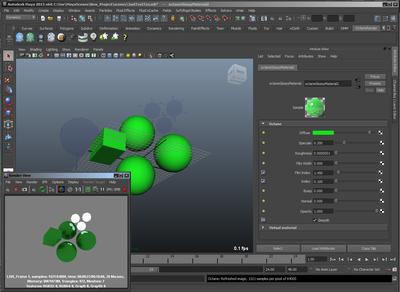

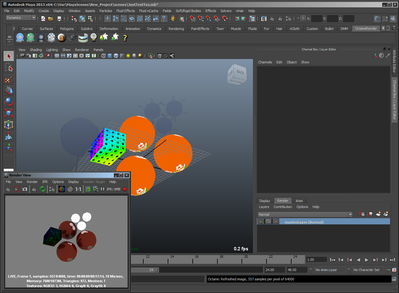

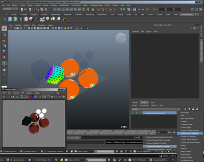

Yes, render layers are supported (they have been implemented from the beginning), I just did not hear about someone who is using the "material layer overrides", so I don't have the feedback from users about how stable it works. But I just checked one more time on a simple scene - all works OK with material layer overrides. Moreover, Octane settings have its own additional checkbox "Render in gray material" - to just quickly override all materials of scene in all layers with gray diffuse...
