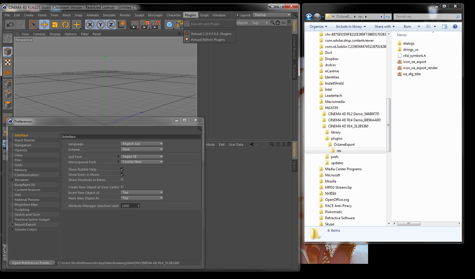

I am curious to try out octane with Cinema 4d, but im baffeled as to how you get the plugin to work?
Could anyone be kind to point me in the right direction on how to install, or were to put scripts and plugins in cinema?
Have a nice day.
win 7 64 | intel i7 quad 3.4Ghz | geforce gtx580 | 16 gb

strollinthewoods wrote:I am curious to try out octane with Cinema 4d, but im baffeled as to how you get the plugin to work?
Have a nice day.
In the last C4D releases the plugins should be installed in the user MAXON folder. You can find it by opening C4D and then the preferences dialog. At the bottom of the dialog you will find a button "Open Preferences Folder...". Click there and you file manager opens in that folder, which has a subdirectoy "plugins". Into this directory you extract the corresponding archive posted in the initial post of this thread. You should then have a directory "OctaneExport" inside of this plugins folder.
Then restart C4D and select Plugins -> OctaneExport -> OctaneExport, which will open a dialog which can dock into your layout. The rest works similar as in with most export plugins which is described in the OctaneRender manual.

Thank you very much. I should be way closer than I was ( I had located the normal plugins folder in the install directory, but not the one on the user )
I have now extracted the octane exporter to the plugins directory, restarted cinema , but it still shows up empty cinema- I`ll include a screengrabs just in case there is something pivotal im missing here.
Thank you very much for pointing me in the right direction

strollinthewoods wrote:Thank you very much. I should be way closer than I was ( I had located the normal plugins folder in the install directory, but not the one on the user )
Which archive did you download and unpack? In your case it should have been "OctaneExport_0.12b_win_r12.0_release.zip" and you should find an OctaneExport.cdl64 and OctaneExport.cdl in "...\plugins\OctaneExport\".

ahh.. I downloaded the exporter a late night, and just scrolled down until I found the right version, and thought my only consern was to find the right place to put it, and I see now that I downloaded the mac version. And thats the reason it wont show up.
Fixed it now, and look forward to start testing =)
