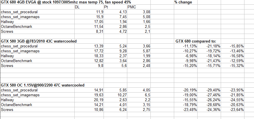

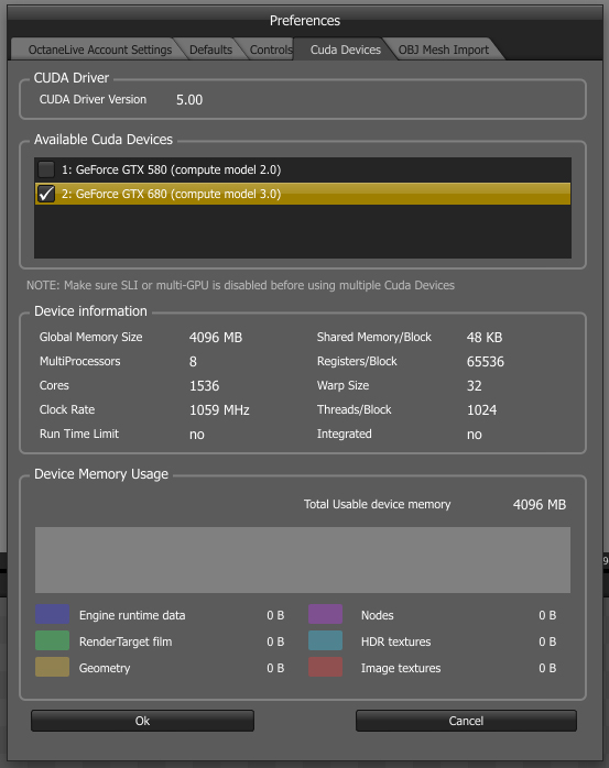

One of my faulty GTX 580 3GB was replaced with GTX 680 4GB http://www.evga.com/Products/Product.as ... P4-2686-KR. The card is very silent. During rendering it works under 45% of fan max speed which makes this card inaudible.
Test scenes were downloaded from
http://render.otoy.com/forum/viewtopic.php?f=33&t=24081
I'm attaching scores compared to GTX 580 3GB on Octane 3.03 and nvidia 306.23 driver, cuda 5.0.

thanks for this =) really useful - actually looking forward to get 680 'cos I'm getting out of patience for new gk110 unit..(an actually in doubt wheather we even see one on GTX line as 680/690 still holds well in gaming and I'm honestly doubt that NVidia would like to eat it's profits anytime soon..=)
curious, is there any boost from 680 oc? haven't read anything yet 'bout it. the Temps are really promissing (are You looking to put this under WC block? =)
