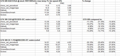

Some scores attached. I'll post OC GTX 680 watercooled soon.
