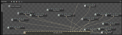

If Your asking about something like this?? Than I know how to do that.
I've had empty nodes with no materials attached to it, and then I was connecting those :)

No. Triangle means that it already read from materials name of imported OBJ. If it doesnt, it leaves emtpy circle, and if You connect material there it will fill up. You will have material added in nodegraph , but its basicly the same thing. I was making this becouse I forgot to change some names, and something didnt import.
