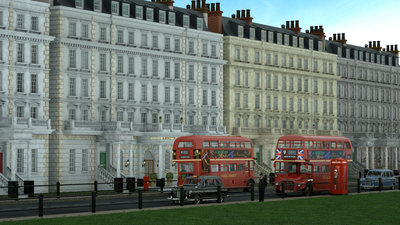

Hello, I have done new tests about instances used for classical architecture details.
I wanted to see the ratio Memory used/Time to prepare the setup/Render time.
I have tested on one of my detailed buildings.

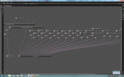

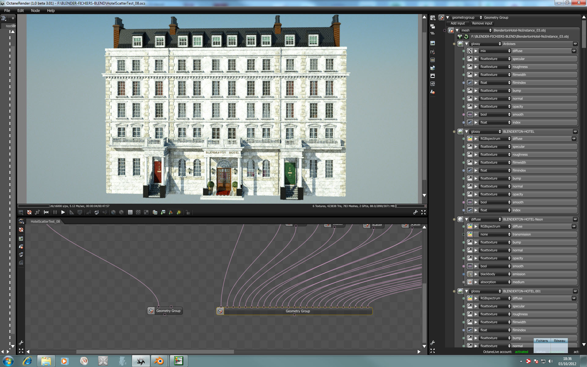

The first images below shows the Memory use and render speed with a very simple nude structure as initial obj file on which I added all architecture details that can be repeated at least twice, by instances. It required many exports for obj details and csv scatter files, and so much work and time to build the setup in the graph editor.

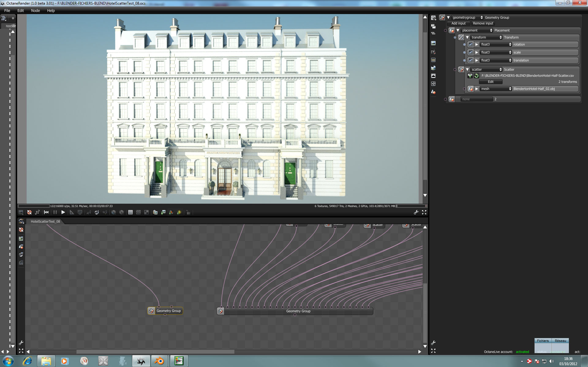

The second image shows the same building (materials not adjusted) with all details on it, just cut in half and instanced with a symetrical instance.
The render speed is around 7x faster ! The memory use is not much different : 88.0 MB with high use of instances, versus 103.4 MB with just the building cut in two parts. Considering that the central part around the main door has not been actually cut in two and is repeated, there is no much difference.
The third image shows the difference of complexity in the two setups.
If you think a moment that the whole setup may have to be repeated, a high use of instances can lead to a very crowded screen and much work for no significative gain in term of memory and a huge loss of computing power.

But there's no materials on windows on the second render.
With textures render still be more faster ?
Materials are there. They are just not adjusted, but you are right, some procedural textures are missing, and have an effect on render time, but globally, there are many less materials, as instancing architecture details requires to duplicate their materials as well. So, the render speed may be not 7x faster, but in my last test at least 4.5x with less work and complexity.
