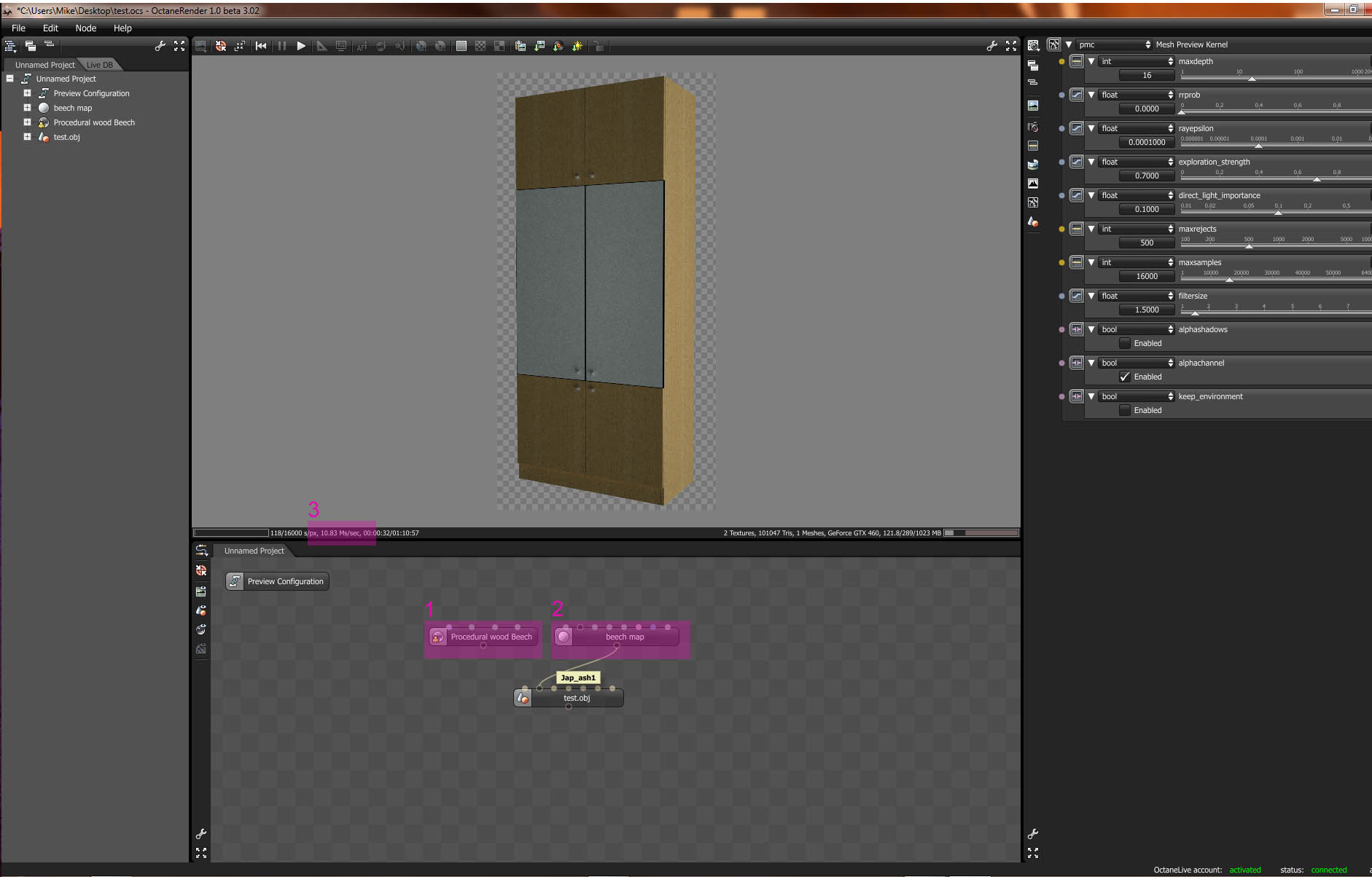

having a moment to test it, i've observed something that you all might be interested in.
Not sure if a few of you could corroborate this.
I ran a speed test using an online Procedural texture and a home made texture using a .jpg map.
please see the attached results below.
