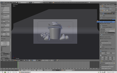

Narcissic Camera Screen Dump...
I can render the camera view with the normal blender render command with no errors, as soon as I do Octance render error message.

You have the camera object set as the camera focus object, so it's focusing on itself. :)
