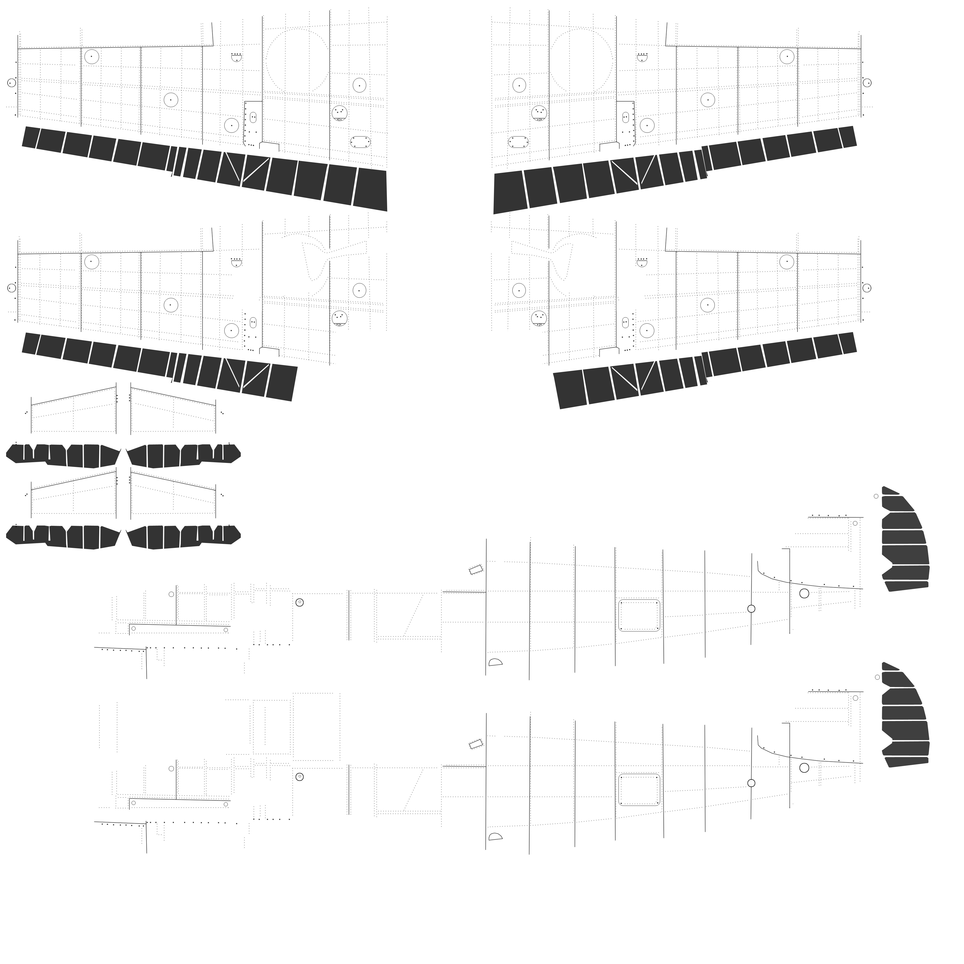

i don't have any good results with beta2 + bump map (at VERY LOW POWER SETTINGS) - and any photoshop smoothing can't fix this. Please explain what could be wrong here? Wrong bump map format?
thanks for your attention!

i think there is a bump map sampling distance issue here.
i need to add some routines to our bump mapping code to handle maps with fine lines/dots like this.
i will add these to beta 2.1
