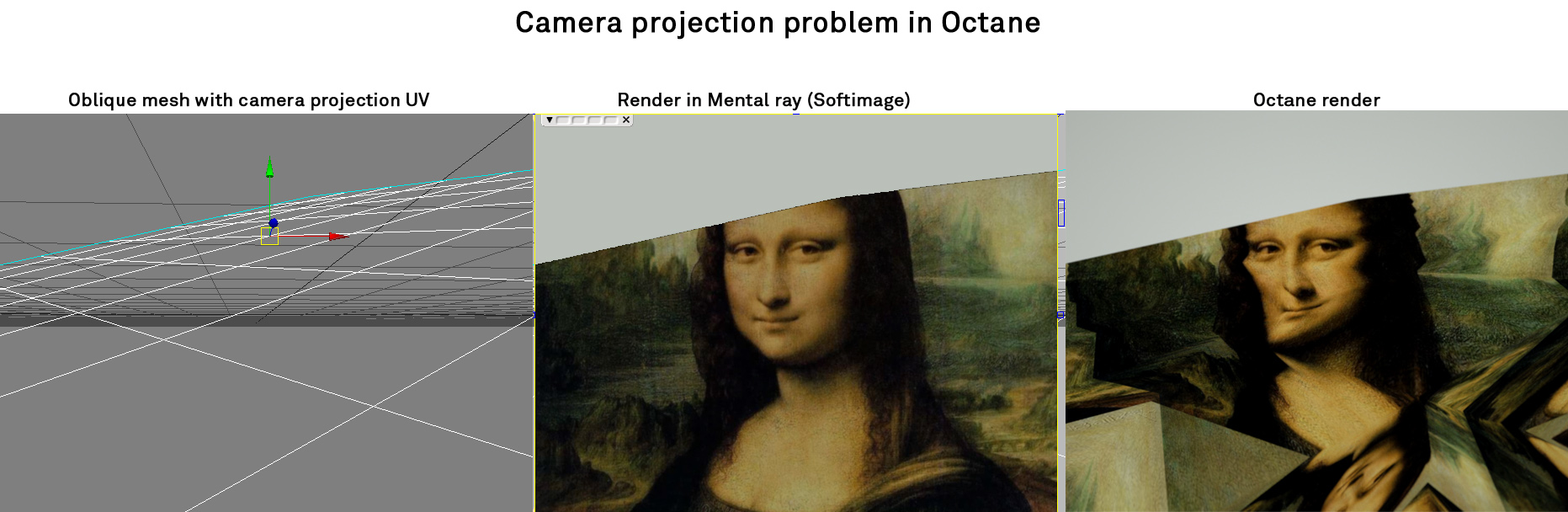

This is a recurrent problem that has affected my work and I bet many of you have the same problem when dealing with meshes that have Camera projected UV's, these are essential when you want to mix CG images with real photographs.
When I render my meshes with camera projected UV's and textures in softimage I have the result I am expecting, but when I switch to octane the textures get completely messed up, specially when the surfaces are more oblique to the camera.
This is an issue that I can partially solve by subdividing the mesh, but even then the final result has distortions, and can make a simple scene become heavy.
Is this a bug in octane? could it be solved by octane team, or am I doing something wrong?
I attached an example to show you what I mean!
Best regards
Filipe

try triangulating your mesh before projecting the UV's onto it?

I just tried triangulating the mesh before applying the UV's, but the problem persists...

Modo has the same problem, not so extreme but it was there...
Workaround would be to render out a material id with the info kernel and compose it later...

Do you think the problem is caused by Softimage, or is it Octane?
It must be something about the way octane and softimage interpolate the UV's...
Yes, I usually composite with material ID, but it would be great not having to do it,
also reflections and other secondary bounces will be affected by the distortion...

The problem is caused by Octane.
Modo has the same problem when i create a plane and use a camera projection.

Octane doesn't support this at the moment. UV coordinates of a point are found by linear interpolation between the UV coordinates of the vertices. The projection of the texture to the quad is a projective transform, it needs a kind of non-linear interpolation. I can put this feature on our the TODO list.
