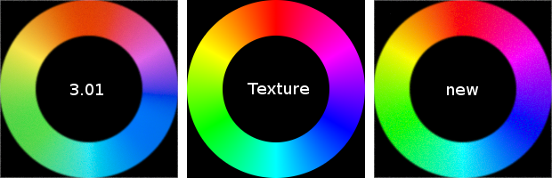

In the following image you can compare a color wheel texture with a rendering of this texture on a quad. The
renderings are tonemapped without film curve and with a gamma value of 2.2, and the texture was loaded with
the same gamma value.
On the left the previous release, on the right is the improved version.
Note the improvement in saturation, and the accuracy of blue hues.

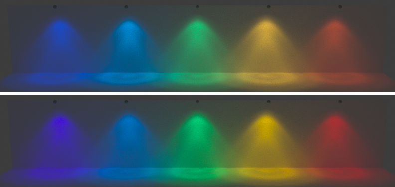

Another test image: a simulation of some LED colors: indigo (430nm), blue (470nm), green (525nm), amber (585nm)
and red (660nm), using Gaussian spectra. The new version is at the bottom.
The indigo looks like the deeply saturated blue as it should, and the other colors, especially the red, are properly
saturated.
