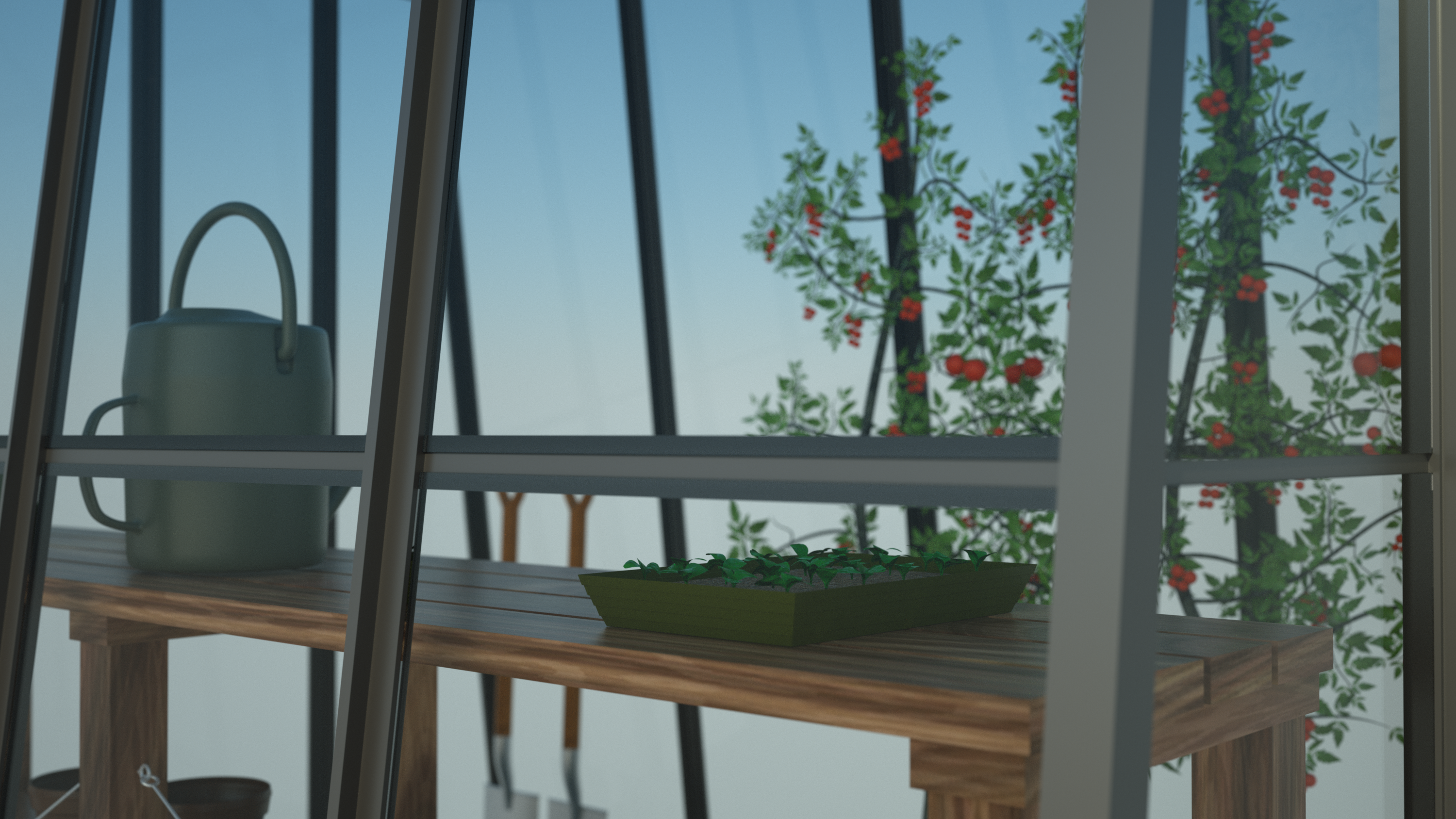

This was only part of a much bigger scene anyway but whilst I was modelling the green house I thought that I'd get some WIP renders.
Here is the scene. I was trying to focus on the seedlings.
