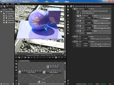

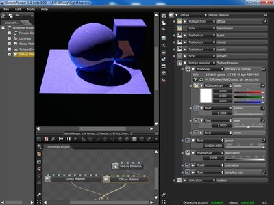

Here is a trick that could help you, create a powerfull HDR white map on a poly(in c4d I bake a poly with high luminescence in hdr format) next you place it far away and above your scene and normal must point on the object you want to light.
Here is the result in octane
