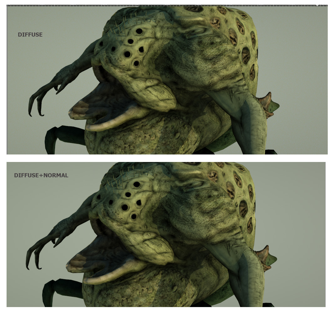

Good question and maybe i'm doing something wrong also, but the normal map isn't doing anything when combine with a diffuse texture - maybe its normal(no pun intended)?

Son, what kind of lighting do you have on the object? It looks rather diffuse, afaik diffuse lighting isn't going to show up normal maps...

James wrote:Son, what kind of lighting do you have on the object? It looks rather diffuse, afaik diffuse lighting isn't going to show up normal maps...
you sir are correct - so i'll need to use a glossy material to see normal maps. diffuse+normal map showing "bump" only works in game engines. BTW what other kind of lighting can one use beside diffuse? :?:

Yes you have to put it on a glossy material to see it clearly. Normal maps are the same as used in game engines. There is differences between normal maps when it comes to axis alignment. You have to remember to flip one of the axis in Zbrush before you export the map, cant remember wich now. Il check it out.

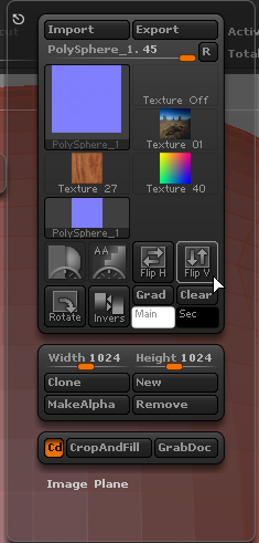

Heres the correct settings for making normal maps inside Zbrush that works within Octane:
Remember to Flip V before you export the normal map:
Cheers

So the green channel should be flipped? I was never good with normal maps. hahah

Yeah flip the green channel in Zbrush before you export
