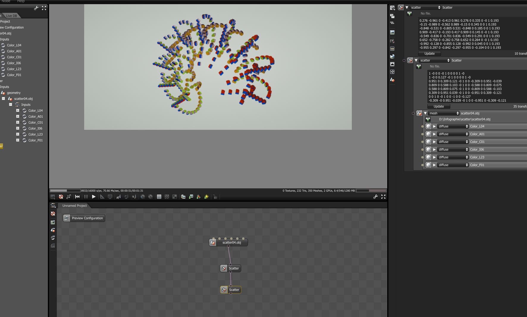

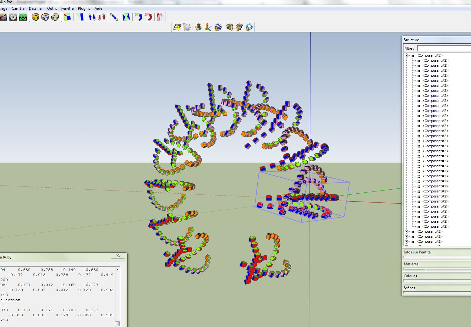

Dear all,
Yes the idea to create a csv from Sketchup exporter should work.
Here is a little ruby script that output to the su ruby script window positions of selected components with yz reverse and scale.
It Sodoes not work as is if more than one rotation around original axis is made... -> needs to work more on matrix transformation operations
but with it I was able from only one component in SU exported to Octane to create this render with 2 cascaded scatter.
Any volonteer with good knowledge of SU script to improve and debug this in order to use Octane instancing ?
Script :
copy and save it as "expcompoctane.rb" in Sketchup plugin directory and restart sketchup
