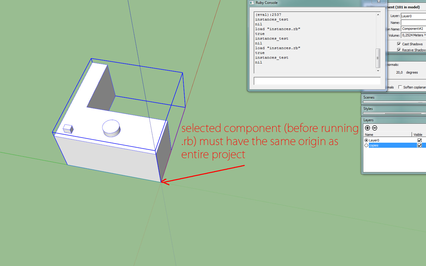

I DID IT !!! BUT your further help is needed :)
Look at screenshots.
Before running the script I moved one of the copy of components into the project origin, to make its axes overlapping axes of the project. Then selected it and type command for running the script.
The last (I hope) thing to input into your code is to make set axes of selected component equal to [0,0,0]. Is it possible?
Thank you again! So much!!!
Reference component must be have identical axes as entire sketchup project

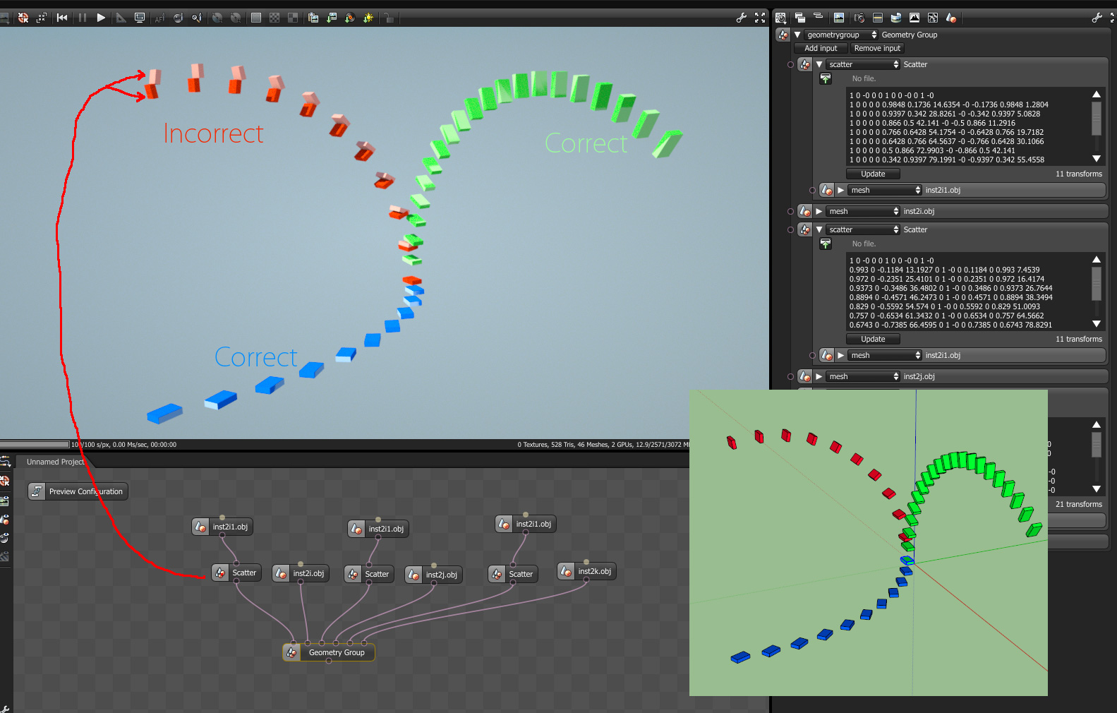

The script works properly only for rotated along green or blue axes (and should work properly for joint rotation along vector in "green-blue space" - I didn't test it yet). I'll try to fix it.
