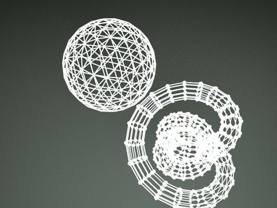

you didn't mention which modelling software you use..
for 3dmax I would use the lattice modifier .. which turns every model into a atom like lattice, just make the ball part of the lattice 0, and you remain with the wireframe, it does add to polycount..but it works pretty much nice for quick wireframing, besides the render wireframe setting..

there's no direct way of doing this... I would go the texture way, do a per face style mapping, where each poly occupies all uv space, and you can use the same texture (a square canvas with an outline) for all your scene if you want to (ideally all geometry should be quads)... meaning there's no need to unwrap everything, render a wireframe from those uvs, assign dozens of materials etc.
