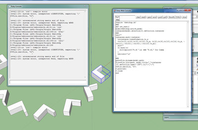

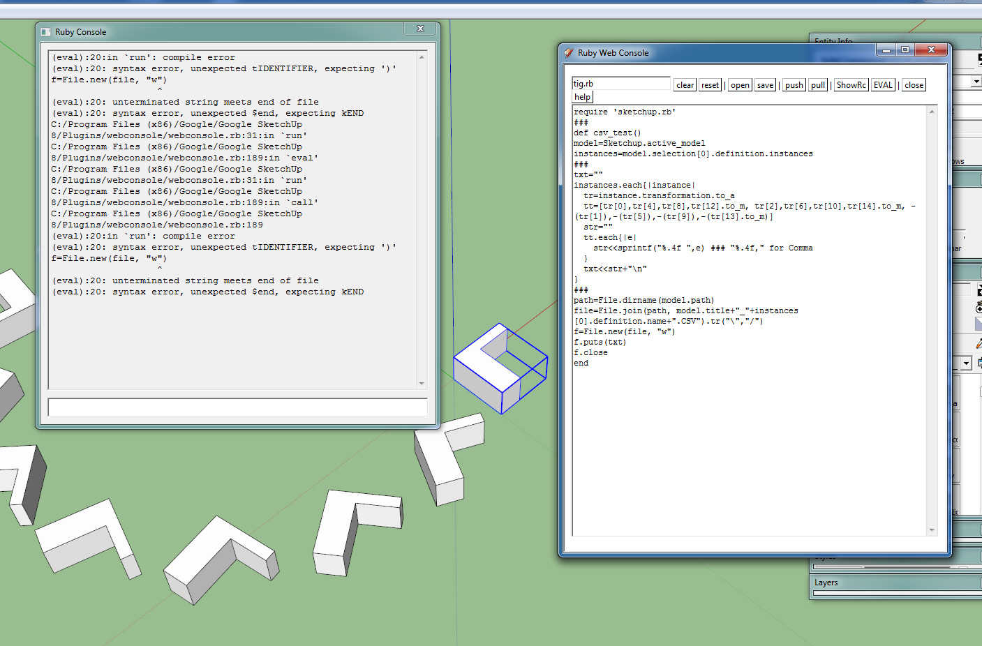

I've never done ruby scripts before. Could you please give me more instructions how to upload the script? I downloaded ruby web console, pasted your code, saved it and hit EVAL and .... what should I do ? See my screenshot.

Forget Web Console etc.
Use the Ruby Console from the Sketchup Menu > Window...
Any file with a .rb file-extension that's in the Plugins folder will auto-load as Sketchup starts.
Or if it's added later or it's in a subfolder you can type a load command in the Console.
load "test.rb"

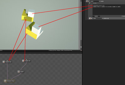

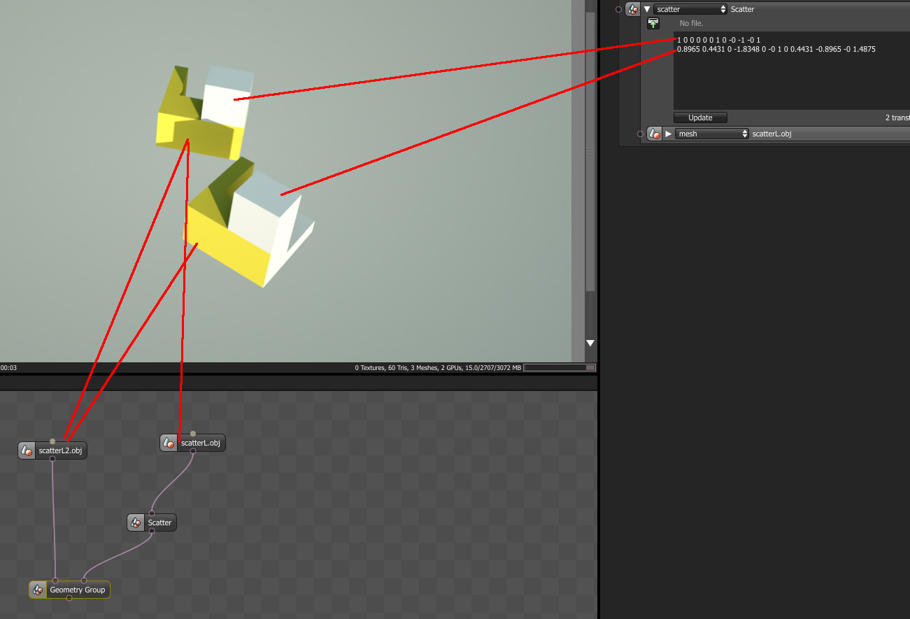

Almost done ! One correction is needed - an object is rotated 90deg. Yellow Ls come from SU, white ones from the scatter.
I was playing with changing an order of elements in a single row but with no results. The first row is
1 0 0 0 | 0 0 1 0 | -0 -1 -0 1
and should be
1 0 0 0 | 0 1 0 0 | 0 0 1 0,
The second is
0.8965 0.4431 0 -1.8348 0 -0 1 0 0.4431 -0.8965 -0 1.4875
and should be...?
How to set a correct order to rotate the object properly? I am attaching .ocs.
Thank you so much again.

This is not a matter of the order only - I was playing with different orders of elements. Look at the first row: there are four ones, should be three of them:
This sequence
cannot be arrange into
1 0 0 0 | 0 1 0 0 | 0 0 1 0.
TIG

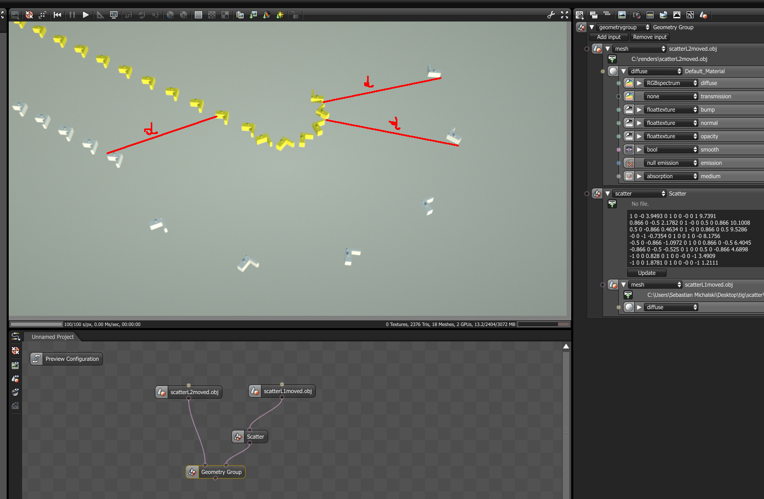

All files are attached - SKP and OCS. I did my best to match appropriate values in scatter data - no success. Sorry.
Could you please try to match white and yellow objects? I appreciate your help.

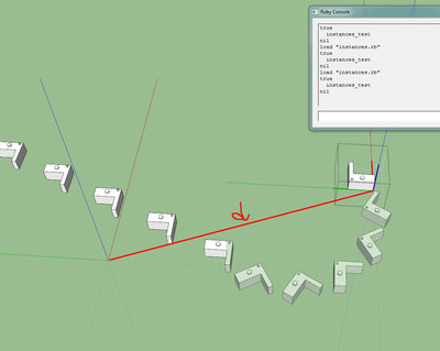

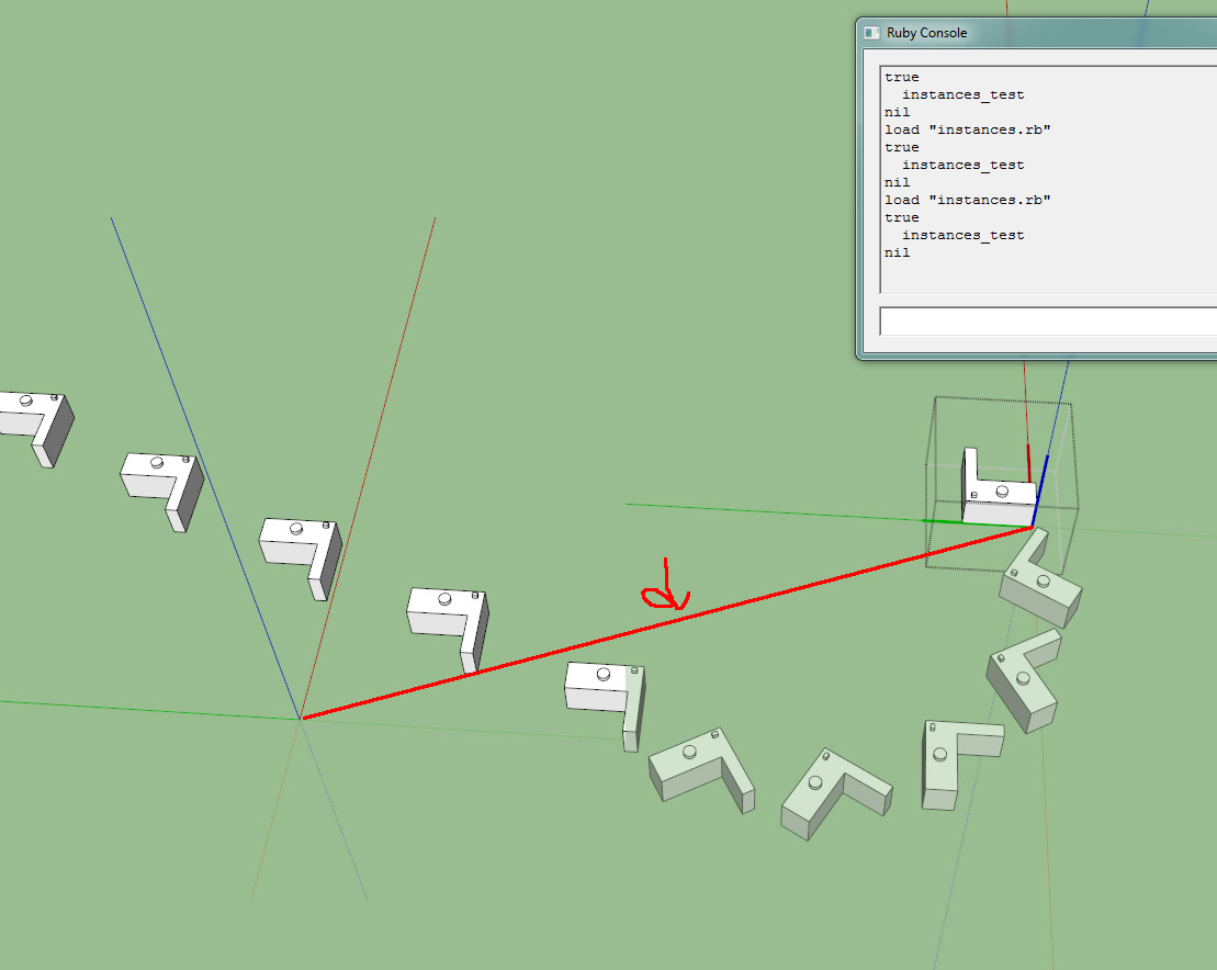

And it almost works! Almost means that to every copy of an component is added extra distance. And that distance is from origin of a Sketchup project [0,0,0] to origin of a certain copy of a component. So the code needs to be corrected again.
tr[12].to_m + correction, distance from origin in x direction
tr[14].to_m + correction, distance from origin in z direction (z is UP)
-(tr[13].to_m) + correction, distance from origin in ty direction.
Please take a look at screenshots.
