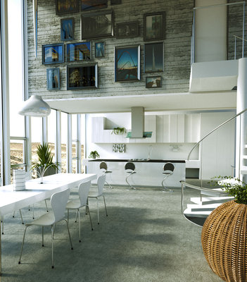

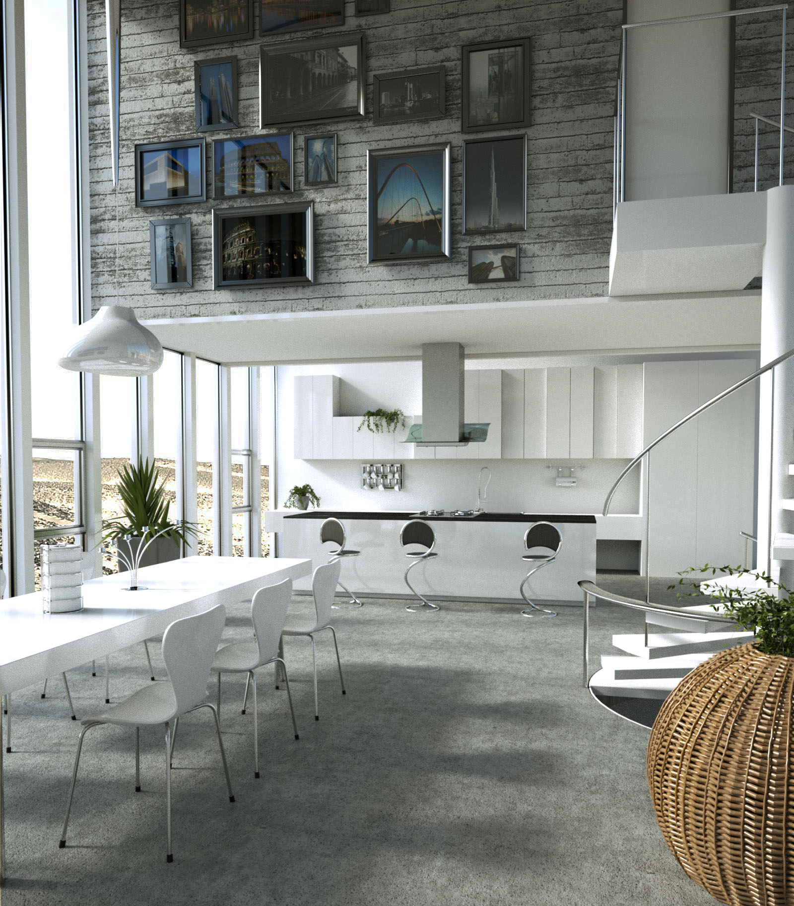

Hello,
i have play a little bit with the octane settings.
My target was to create a realistic rendering, this is the result.
I'm always open for criticism and helpful tips.
I have used direct light + diffuse + HDRI, rendertime ~ 2 hour with one gtx 570
the first rendering looks okay if u dont zoom in but yea you see what i mean.
the second rendering is a little noisly not enough time (~ 1 hour) but without zoom in it is okay.
my favorite is the first render, i´ve invested more time in it.
greeting

I like the design and rendering
But the leaf on the second picture seem a bit strange :)

The bump on the wooden floor is a bit too strong.
Great renders though :)

I like it overall. Nice stuff and colors. The floor has bad scaling so the bumpmap looks out of place. All in all its to grainy and maybe a bit to much sharpened. THe outside desert view is a bit blurry too. So mostly small stuff to fix.
Maybe doing the outside with sharper shadows because its desert and more contrast.

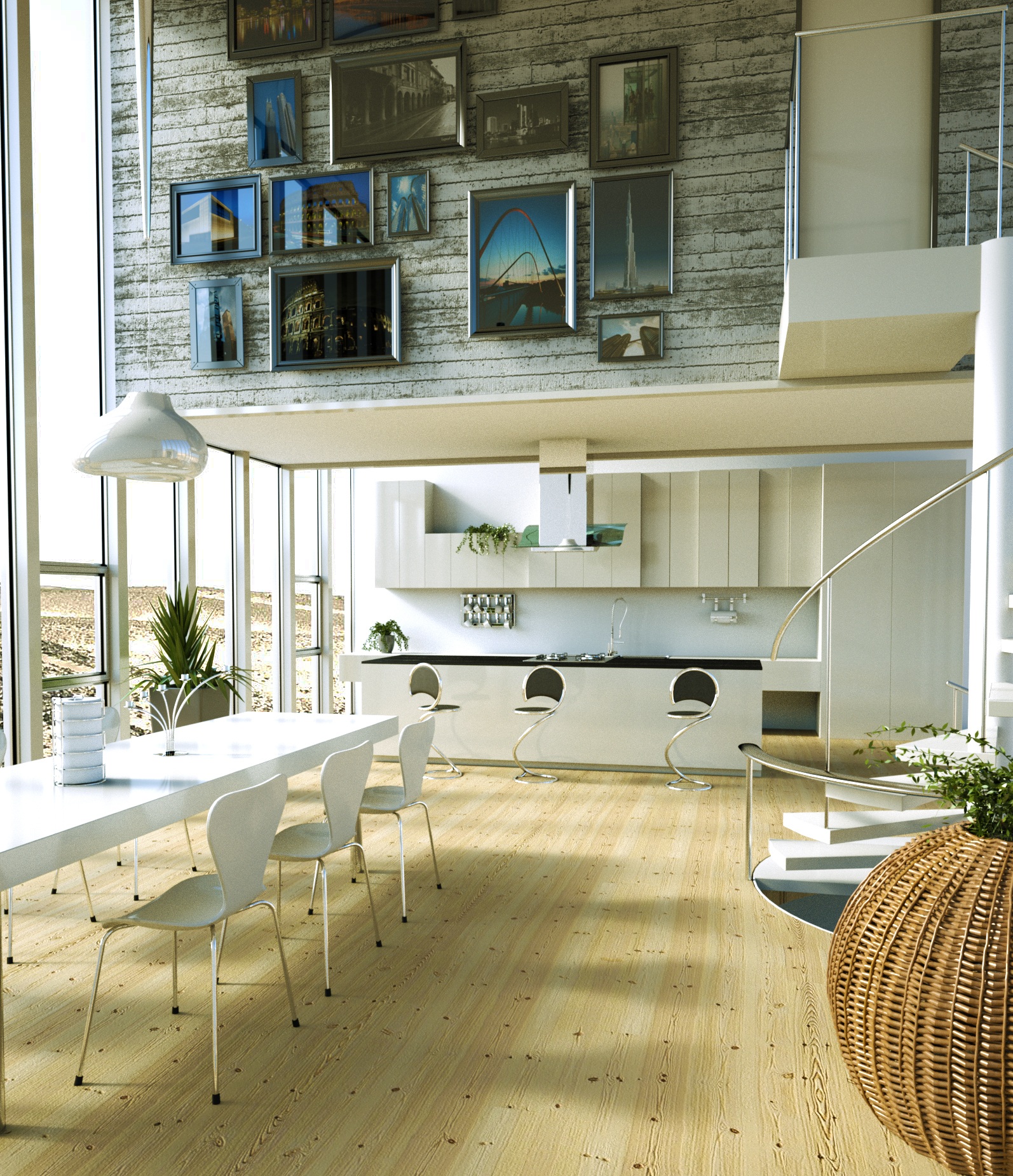

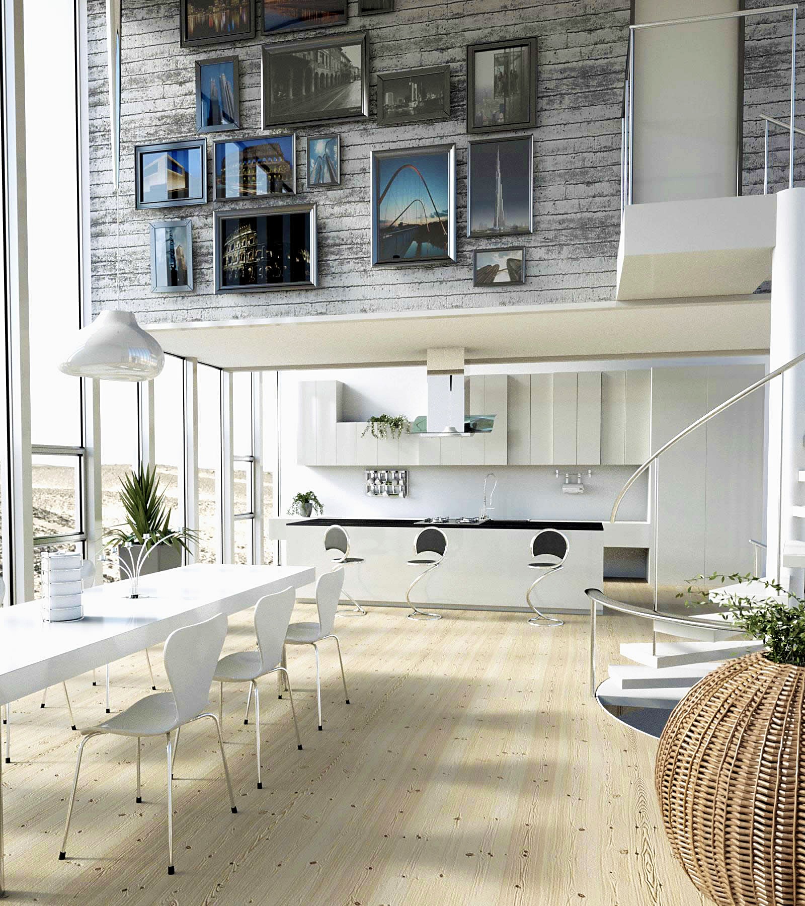

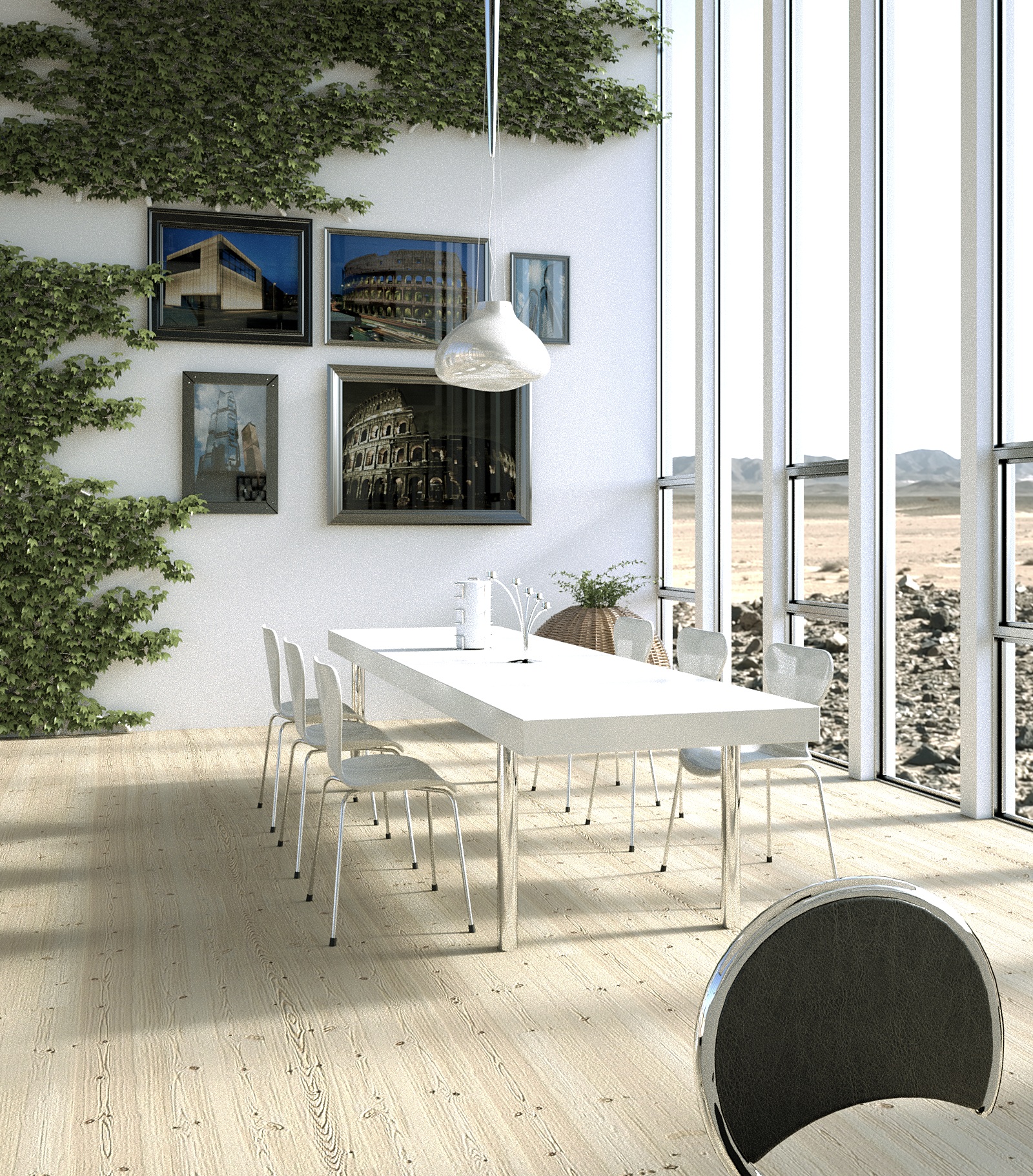

Hello Guys,
thx for your comments and criticism.
@tonycho,
i think you are right the leaf on the wall is too much its looks really strange, thx.
@steveps3,
i sharp it in photoshop maybe too much but i think wood is not the best option for the floor maybe concrete looks nice.
@mbetke,
first of all thx for u criticism mbetke, it has helped me a lot, i have render it again with other floor texture and i think it looks much better now
I know it is noisily, but render and work with only one gtx 570 is hard but I think it is time to buy a second graphics card
finally i thank you all for you criticism i think the result looks better now, my favorite is the first one and the second one, the second one is sharper.
greeting
