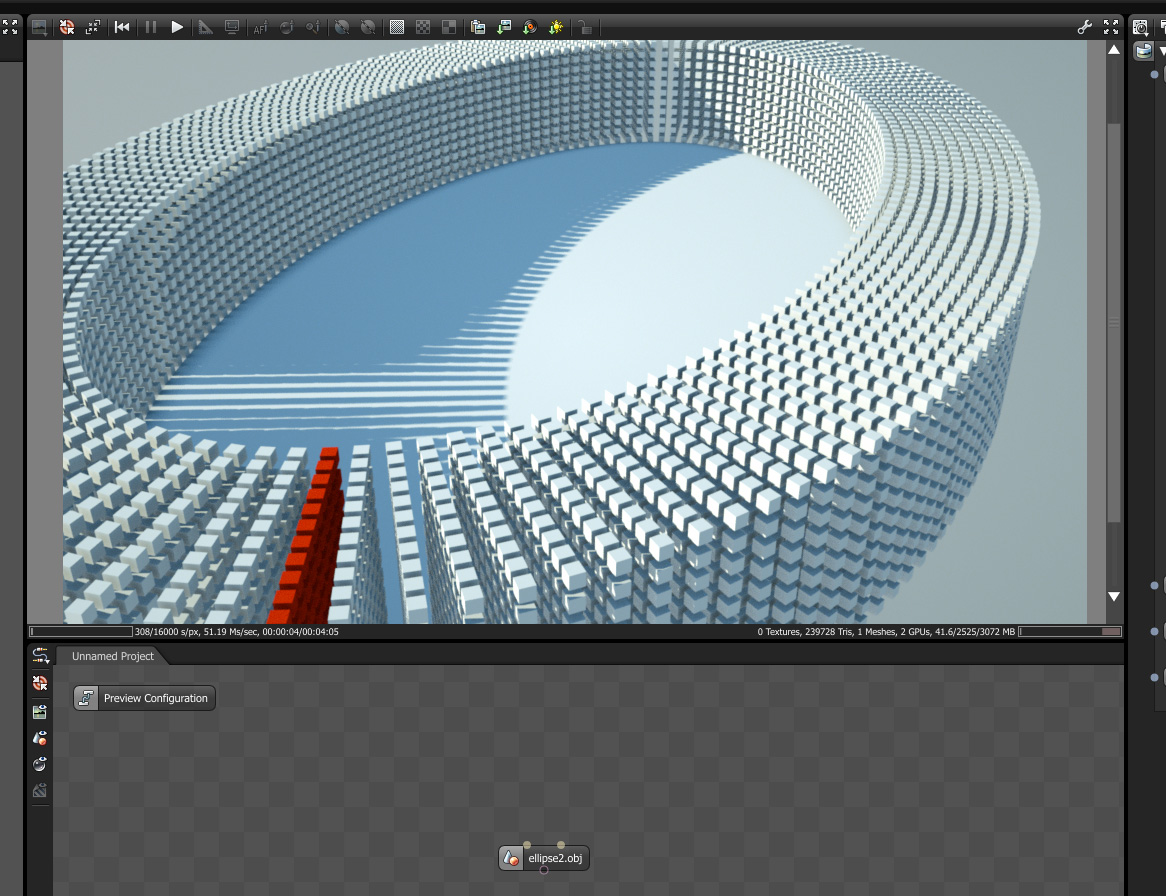

I was not precise in my question - my fault. In my simple example there is a cube (component) copied into 10x10 wall and again as a component copied along elliptical path. I can export it as an entire .obj into Octane (.obj is about 70MB, 41mb of vram). Now assume that every single cube is replaced by 1 million poly shape. Now, how to export such model into Octane? If this is not supported yet, will it be? Or is possible to retrieve coordinates for a scatter node for all of these cubes in Sketchup?

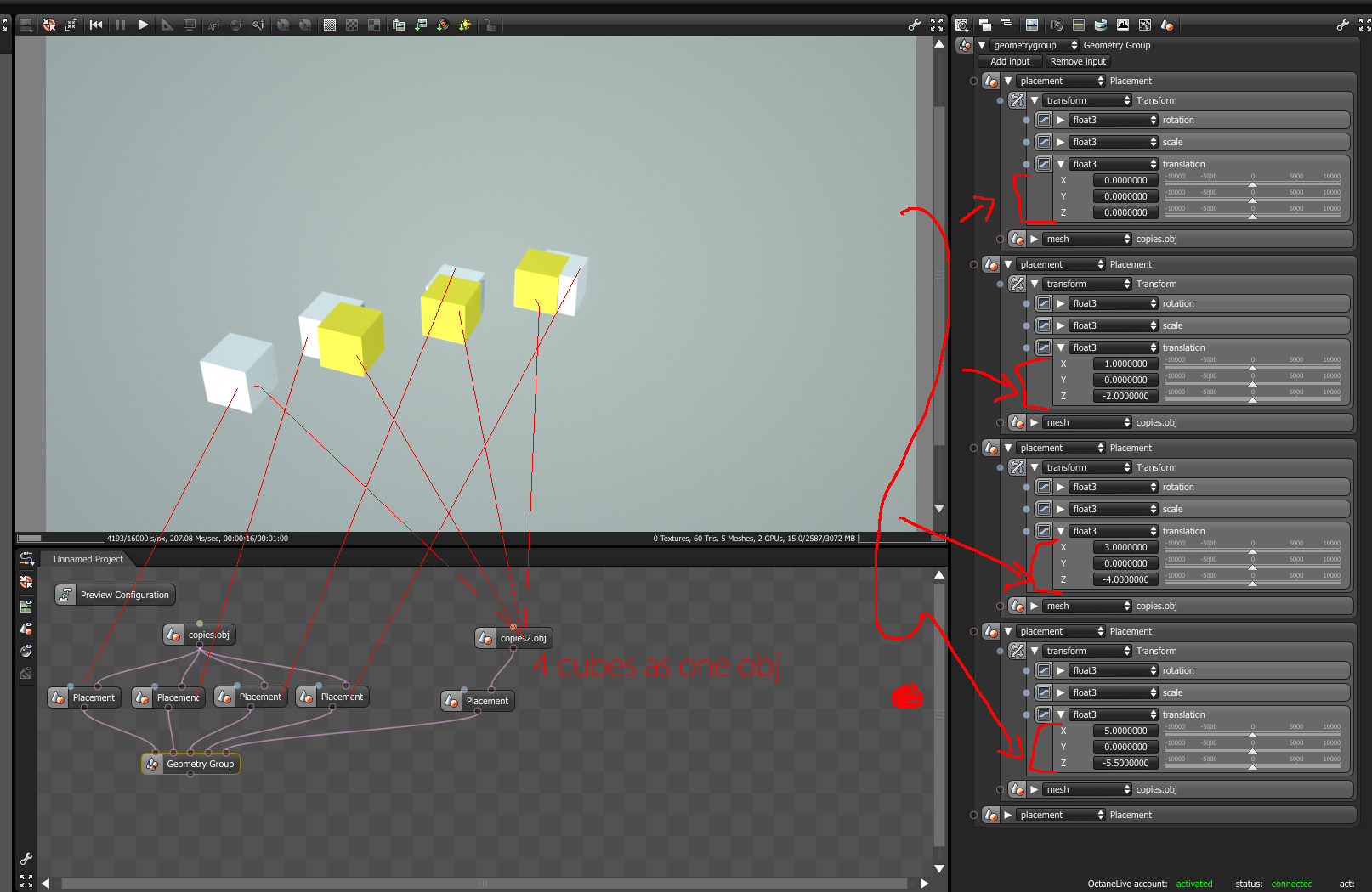

My problem is that I can't retrieve [xj yj zj] from Sketchup for each copy of my component. I can only try to input [xj yj zj] values for each translation vector manually which is painful - white cubes are not overlapping yellow ones. And now imagine I have thousands of them.
So my question is: is it possible to get the values of position/translation of copies of a component?
Thank you so much for your time and help,
smicha
trying to retrieve original location of 4 cubes  using placements
a component copied 4 times

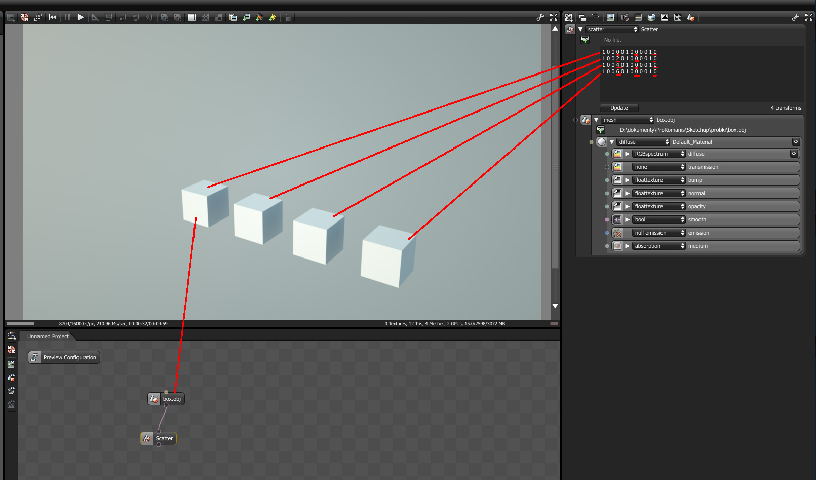

The idea is to upload a csv file or to paste a 12xN matrix, not to do it manually - please see a screenshot.
I don't know how to use the code you sent but if you could be so kind and write step by step instructions how to get coordinates of all or selected copies of a component I'll export it into Matlab or R-project and write my own code to transform coordinates from sketchup into 12xN matrix.
