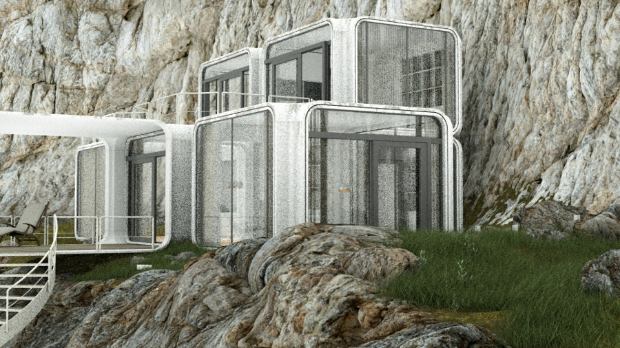

By the way here is a quick test : The workflow :
I export my scene and during the export process the instances matrix coordinates are stored in separate files with the instanciated object as name.
I load the scene into Octane
Add the meshes to be instanciated in separate nodes (they should be exported individually)
Create the scatter node linked to each object
I copy the content of the file containing the matrix and past it in the scatter node for each instanciated object
Create a Geometry group node to mix the main scene and the instances
That's it ...
