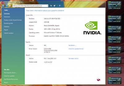

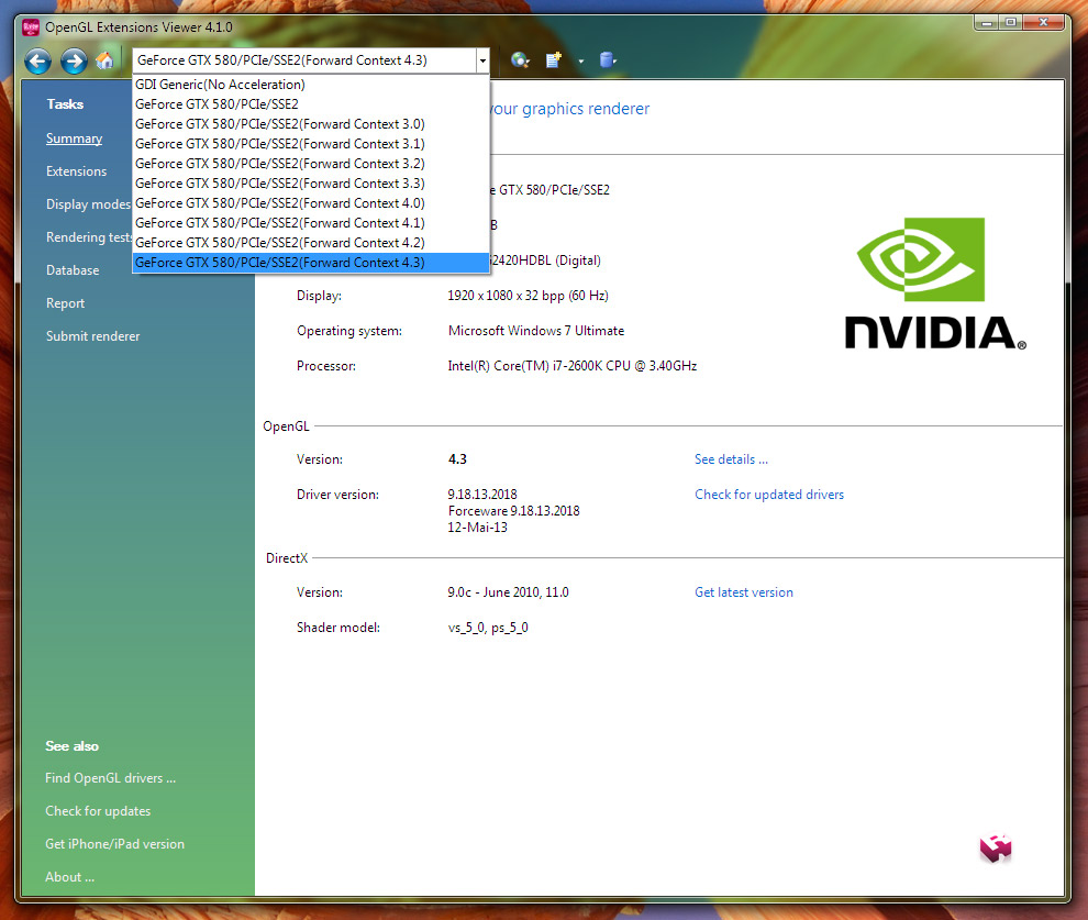

Hi BorisGoreta,
here is a screenshot of the OpenGL Extension Viewer after startup with all my gpus "online".
The first GTX580 is the one in my PC, all others are in the turbobox.
As you see it shows Open GL Version 4.3.
I have only normal NVIDIA driver installed, no CUDA SDK or similar.
The program seems only to detect the first GTX580... so only this one might be in use for Open GL?
What does your extension viewer show up when all 6 cards are active? How about the render test?

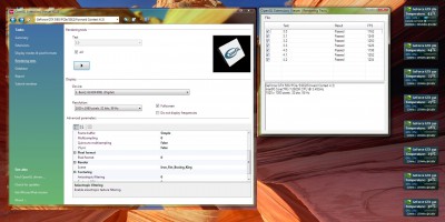

Here is the render test of mine... comped two screenshots together to show it only used the GTX580... at about 30% load, getting about 1200 fps average with Open GL 3.0 - 4.2.

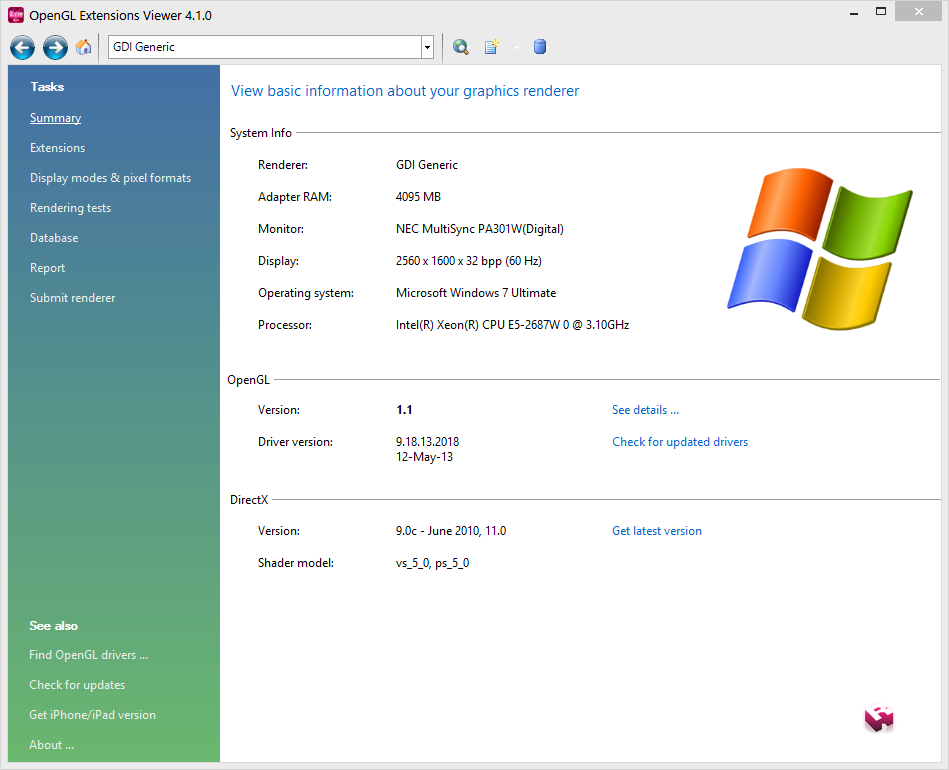

This is what I get with SLI off. Just OpenGL version 1.1 which basically can't do much.
I really don't understand how can you have good OpenGL. It must be something with the mix of cards you have. You're lucky ! :D

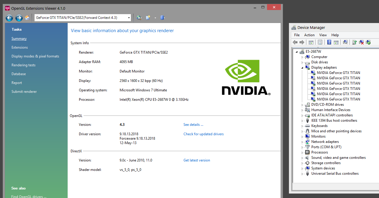

And this is what I get if I disable two cards. You can see in device manager that 2 cards are disabled. Now I get proper OpenGL version 4.3.

BorisGoreta wrote:This is what I get with SLI off. Just OpenGL version 1.1 which basically can't do much.
The attachment Capture.PNG is no longer available
So there is no GTX listed in the dropdown menu, you only get GDI Generic by default (which is basically no hardware acceleration)?
Maybe it has to do with the Titans layout? Is it somehow limited in terms of Open GL?
Or it is a limitation of your CPU or Mobo, I have read about PCI lane limitations of CPUs lately, but did not understand fully how it works. As I think, the CPU or bus system might drop down PCI Express 3.0 or 2.0 to 1.0 or even slower when having too much physical GPU cards installed on one board (too much PCI Express lanes used)... and maybe then Open GL cannot work proberly?
I have 5 physical graphic cards with 8 GPUs, you have 6 physical cards with 6 GPUs... maybe it makes a difference, how much PCI Express Slots are used?
Do you have the same problem, when removing 1 of your 2 Titans in the PC, leaving only 1 Titan in the PC, and 4 Titans in the turbobox?
Did you also check which PCI Express Slot of your mobo the turbobox expansion card is installed to? Is it 16x, 8x, or maybe less? (Not all PCI Express Slots are the same). Did you try different slots?
