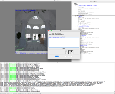

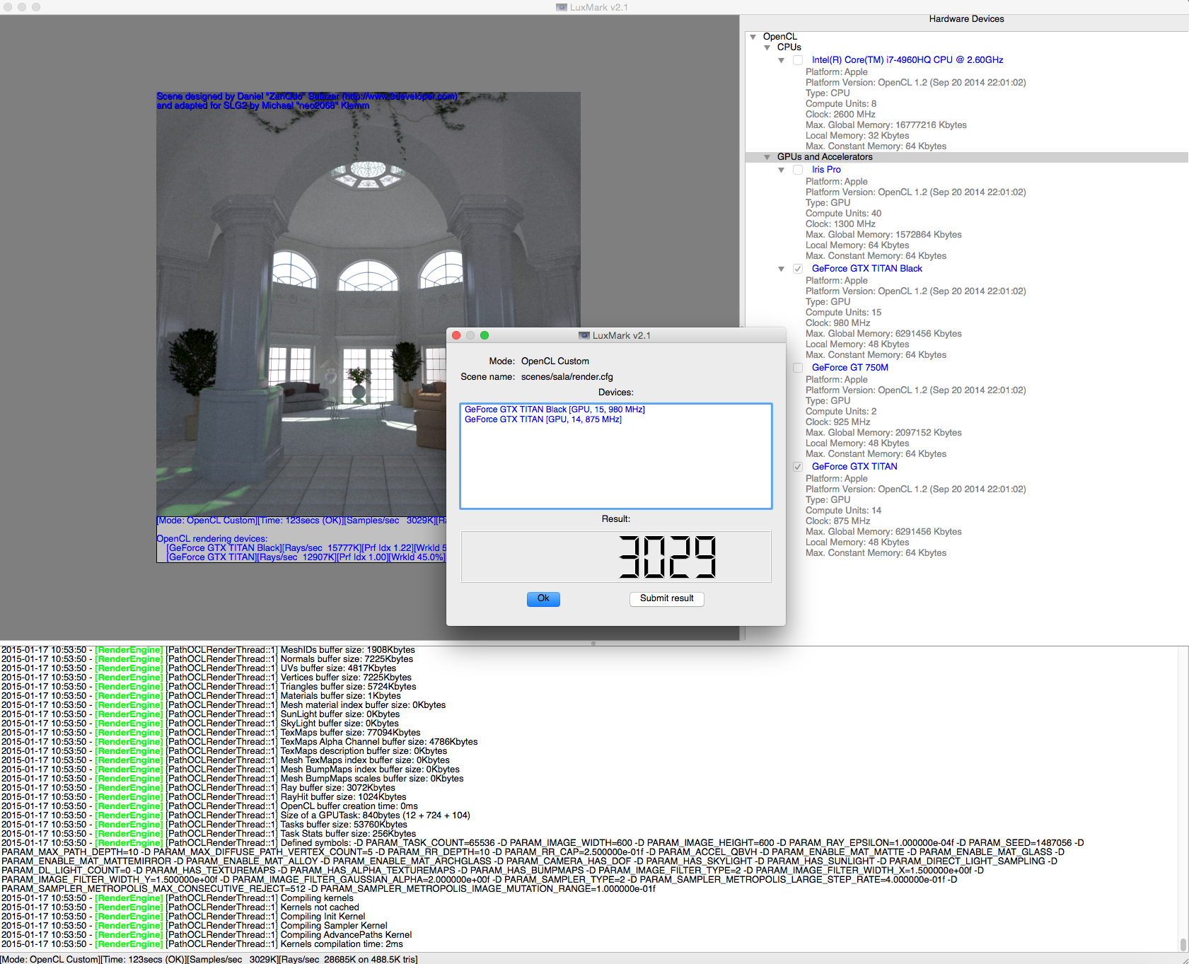

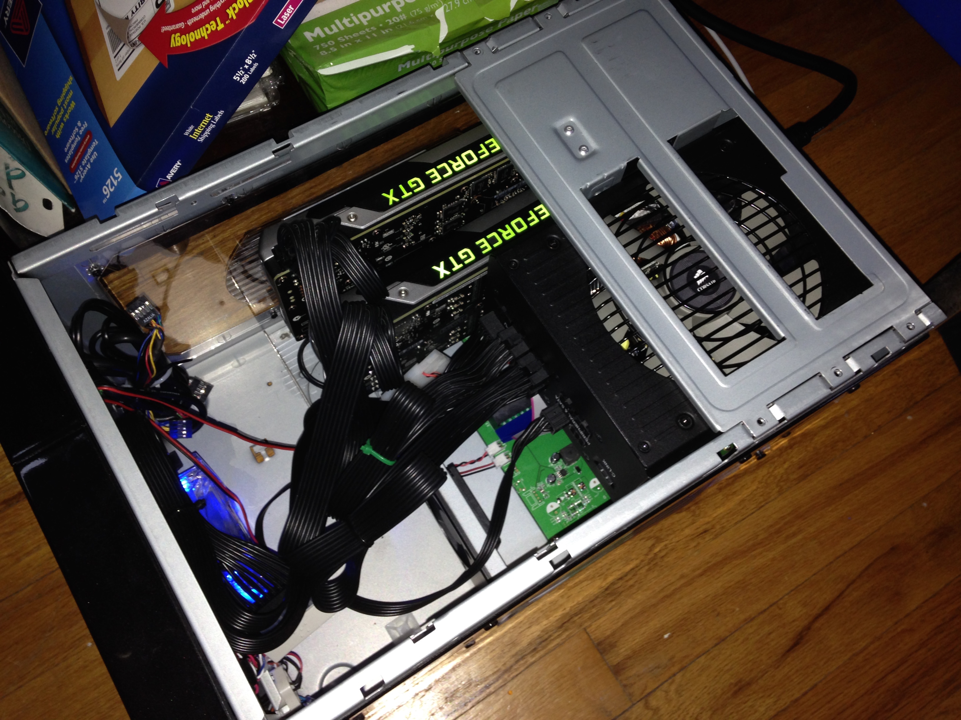

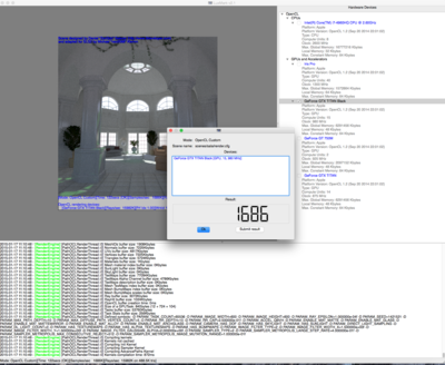

A little update on my latest setup. I decided to add a Titan Black instead of a Titan Z because I got a Black for $600 on eBay bran new. I've got a TITAN Black + a TITAN running on 2 Akitio enclosures daisy chained. I modified this case to hold the kit too. It's not a perfect modification but if anyone is interested, I can post some pics that show the process to modify it which was pretty simple. Here are some benchmarks as well. My tests reflect Jose's finding that daisy chaining doesn't seem to bottleneck rendering one bit. I think if I add another to this, it'll probably be a Titan Z because I'm sure 4 daisy chains would have an effect.
As for a Titan Black or a Titan Z, they both seem to work but the double GPUs can be a little more of a hassle to setup and seem to absolutely require a powered riser. I think the powered riser is a good idea anyhow. I get slightly better benchmarks with a powered riser than I do plugging straight into the Akitio. I don't understand what the cards from macvidcards.com have that others don't. I would just get a regular one if I was you.
Jose's LuxMark Sala benchmark with 2x Titan Zs was 4400. My benchmark with 1x TITAN Black + 1x Titan is 3000. This seems to basically reflect the performance of the cards though. The Titan Z seems to be equal to about 1.5 TITAN Blacks in most rendering situations. Price wise, it seems these cards have varying prices depending on where you buy and you'll wanna add $200 per card for the cost of the Akitio.
TITAN Black Only
TITAN Black Only
Daisy Chained TITAN Only
TITAN Black + Daisy Chained TITAN

The riser doesn't do much. I think it made a big difference with the Titan Z because of all the power needed at the single PCIe slot. With smaller cards, it's basically just a way to power the Akitio straight from the PSU. I think I got slightly higher benchmarks from using a powered riser but whether the riser contributed to that is debatable. Molex to Barrel Plugs also work fine for powering the Akitio from the PSU. All in all, I don't think it makes much of a difference where you power it from though. Just make sure you plug your computer and the PSU and the Akitio all into the same power strip and you should be good to go. I have my setup in a case so the powered risers serve an architectural purpose.
