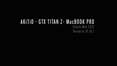

						Here is my Yosemite process for the GTX Titan Zgarytyler wrote:Thank you very much! I owe you one!
Good lock
 Link:
http://youtu.be/cPOB9qmPjaE
OS X Yosemite 10.10.3 | Macbook Pro | 16GB | 2 x Geforce GTX TITAN Z | Akitio eGPU | CINEMA 4D R16 |

This video is great but the same process does not produce the same results on my 2014 MBPr w/ GT 750M + Titan Z. I am still getting the 1 Titan Z & 1 NVIDIA Web Driver in the System ReportJose wrote:Here is my Yosemite process for the GTX Titan Zgarytyler wrote:Thank you very much! I owe you one!
Good lock
Link:
I am curious, if you visit the Extensions section in your System Report and view the info for NVDAStartup, What does it say? Can you post a screenshot of that? I am assuming it's acceptable for the driver to not be signed or loadable as long as it's status is Loaded: Yes. This is what the developer sudo command is for.
I'm installing a Boot Camp Win 8.1 now to test my card and make sure it is not faulty.

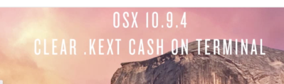

Also, I noticed the video at 9:12 has this title that refers to Mavericks. Is this a typo or am I missing something? Thanks again Jose!

						Yes, Thank you. Is a typo.
Are you using a riser or you connecting straight to the AKiTiO. I have your problem when I connect straight to the Akitio. Try the riser.
I just set up a Macbook pro mid 2013 with Thunderbolt 2 and I connect 2 Titan Z using thunderbolt daisy chain.
