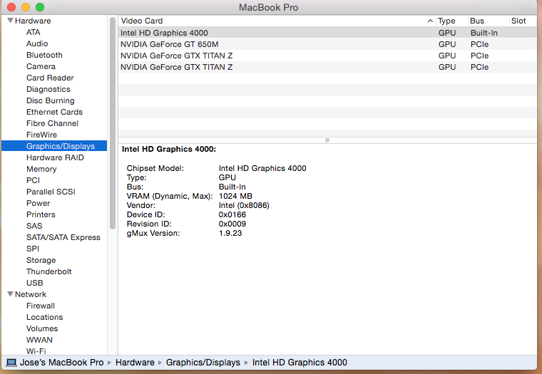

garytyler wrote:jose, I saw you are having some problems with crashes when u boot with a Titan Z? Are you using Mavericks? When I upgraded to Yosemite, I was able to install the newer Nvidia drivers and it solved my issues with any crashes I think. I was, however, able to use my Titan Z in Mavericks, but I had a couple crashes and decided it was time to upgrade to try the new drivers.
I am trying to figure out why my Titan Z is booting like this, as 2 cards but only 1 that labeled with the driver. Anyone have a clue?
I install Yosemite 10.10.1 did all the process and finally have my Titan Z running :lol: I'm so happy right now.
if you want we can go step by step on till you get the 2 Titan Z.
when I was using mavericks i got the same as you 1 Titan Z and the chip one.
OS X Yosemite 10.10.3 | Macbook Pro | 16GB | 2 x Geforce GTX TITAN Z | Akitio eGPU | CINEMA 4D R16 |
OMG PLEASE PLEASE What do I need to do??? You are the man!

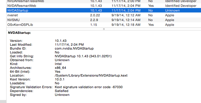

Does it have to do with this?

That looks a lot like the signature validation error in Yosemite. Did you follow the instructions here:
http://www.journaldulapin.com/2014/12/0 ... -yosemite/
This happened repeatedly for me when I upgraded an MBA to Yosemite, until I started fresh and followed the steps exactly. I finally got it working and it's amazing to see octane rendering on a MBA, but I decided to stick with Mavericks for my work laptop due to the other software in my workflow having incompatibilities with Ysemite.

That makes sense. Strange that the driver would load for one half of the card and not the other, but some of the info in this link makes it seem possible that this could be it. I'll try following this exactly and see what I get. Thanks.

It appears the terminal command _must_ be executed before modifying the kexts.

Jose
Posts: 32
Joined: Mon Nov 10, 2014 6:13 pm
garytyler wrote:Does it have to do with this?
I will try to record a video today with all the steps. ;)
