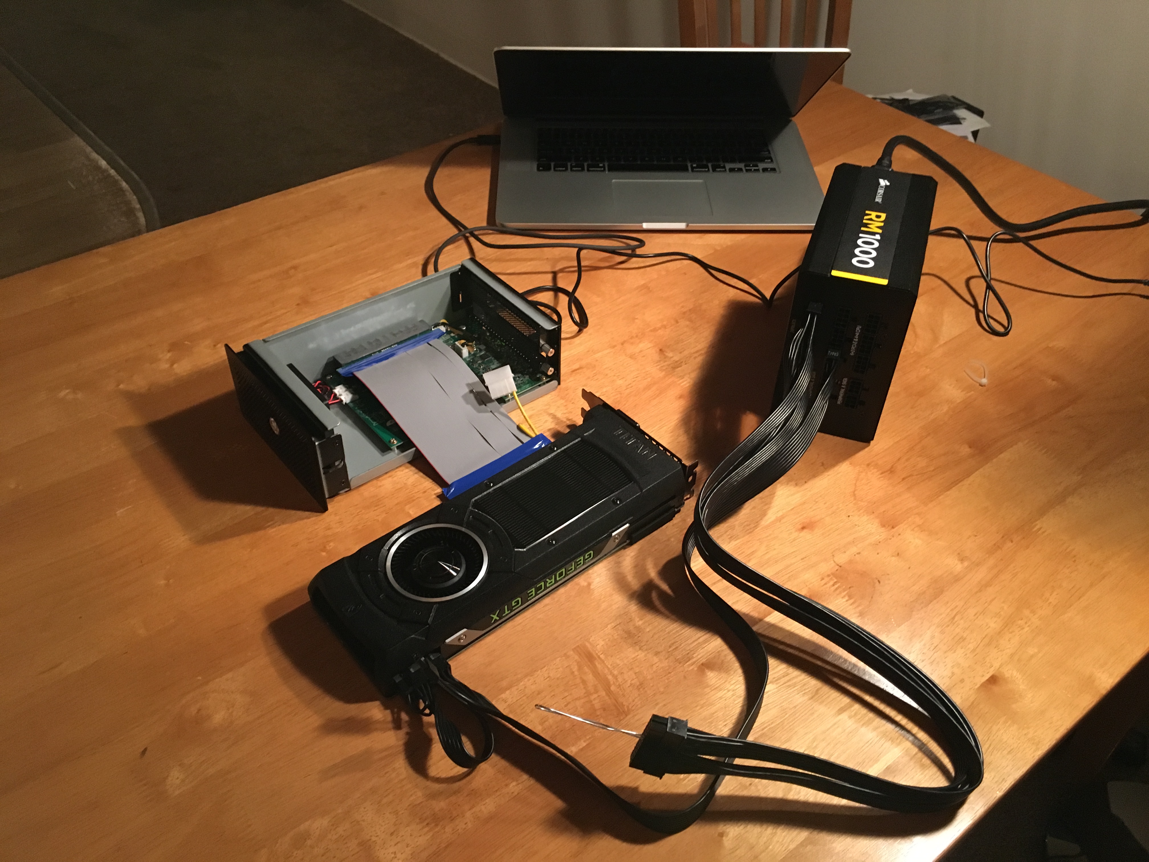

Hey everyone.
This is my first attempt at building an EGPU setup. The task has proven a bit more difficult than imagined. Currently, I am having a hard time getting my Corsair RM 1000 to power the Titan X. I understand that the Corsair fan won't turn on without stress, but I am unable to get the Titan X fan to spin as well, or show any indication of turning on.
My specs are:
Akittio Thunder 2
PCIE Powered Flexible Extender Cable
Corsair RM 1000
Titan X
MBP 2014
Thanks!
My specs are:
Akittio Thunder 2
Corsair RM 1000
Titan X
MBP 2014
Thanks!

have You shorten 24pin cable?atcovrett wrote:Hey everyone.
My specs are:
Akittio Thunder 2
Corsair RM 1000
Titan X
MBP 2014
Thanks!
Wouldn't that require running/installing bootcamp? I am attempting to follow this video: https://www.youtube.com/watch?v=QfKb8TcHDkIwhersmy wrote:try adjusting the fanspeed manually with a program like msi afterburner or evga precision
when i connected a gtx960 through e.c. i also noticed 0 fanspeeds, thinking it wasnt working, but win7 recognised it. Then when rendering I just turned the fans on and it worked flawlessly
I have purchased all of the same equipment, with the exception of a TitanX instead of Z. However, his video doesn't detail the process of physically setting everything up.
and Tom, the Corsair RM came with a 24 pin, as well as everything else. Currently I am running an 8 Pin that splits to two 6+2 Pins (attached into the Titan, with the additional 2pins hanging off to the side)
I noticed that when running that to the GPU, as well as attaching the 24 Pin and using the paperclip method on that, the PSU will click when flipped on. (So far thats the only indication of running power, as the Corsair's fan won't run without stress)
Thank you everyone for the replies, I appreciate it so much.
Alright, small update. I discovered that by powering on the akitio, the GPU card was able to power on. (I suspect by pulling through the Powered Riser) However, I understand that the Akitio itself doesn't supply ample enough power, thus the need for the Corsair RM PSU. I am wondering if I will need to create a Molex-barrel adapter, in order to transfer power from the PSU to the Riser, and in turn the GPU? I have attached a photograph for clarification.glimpse wrote:atcovrett wrote: have You shorten 24pin cable?
Also, I've noticed that my Molex appears different, in that it doesn't provide a 4-pin converter. Is this the issue?
