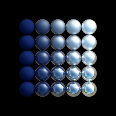

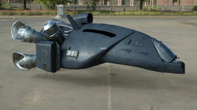

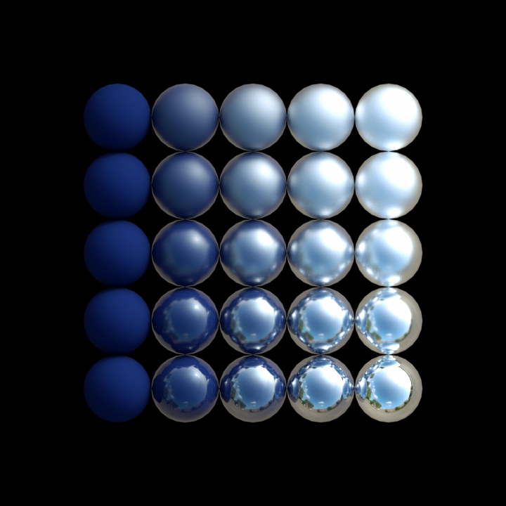

OK, I couldn't sleep so I had to try this. Firstly, I followed your steps pretty much to the letter. Then however, I found that plugging the inverted gloss into your remap gradient node was not working. It was kicking out an almost white file. This has been one of my bug-bears with the gamma in the LW plugin. Inverting a gloss, does not just make it a working roughness. I cannot figure out what your gradient is trying to do, so I reverted to my version which is simply.. Gloss texture at gamma 1, plugged into a colourcorrect node which is inverted and at gamma 2.2. It's the closest I can get to looking right. That all looked good, but the fresnel effect (which I'm guessing is the effect that can be seen at glancing angles? ) was present in what should be painted bits. So, I duplicated the whole set-up, removed the falloff node and just had the specular pluging straight into one of the gloss nodes. Used a colour correct node to make the specular basically black and white (I'm guessing a metalness map would be best for this in reality), and used that as the input to the material mix node. You can see there is no fresnel effect on the painted parts of the body, but it is on the canopy (which is some kind of metal (in my reality anyway
What do you think Miko3d? Does it look any good? I've tried it on my spec/gloss balls array too.
Hey Gordon,thats looking pretty sweetgordonrobb wrote:OK, I couldn't sleep so I had to try this. Firstly, I followed your steps pretty much to the letter. Then however, I found that plugging the inverted gloss into your remap gradient node was not working. It was kicking out an almost white file. This has been one of my bug-bears with the gamma in the LW plugin. Inverting a gloss, does not just make it a working roughness. I cannot figure out what your gradient is trying to do, so I reverted to my version which is simply.. Gloss texture at gamma 1, plugged into a colourcorrect node which is inverted and at gamma 2.2. It's the closest I can get to looking right. That all looked good, but the fresnel effect (which I'm guessing is the effect that can be seen at glancing angles? ) was present in what should be painted bits. So, I duplicated the whole set-up, removed the falloff node and just had the specular pluging straight into one of the gloss nodes. Used a colour correct node to make the specular basically black and white (I'm guessing a metalness map would be best for this in reality), and used that as the input to the material mix node. You can see there is no fresnel effect on the painted parts of the body, but it is on the canopy (which is some kind of metal (in my reality anyway)

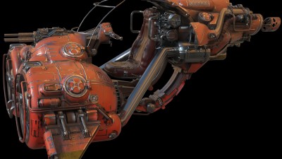

I've done some more work on it, and dug deeper into your shader. Would love to have a natter in the hangout if you're up for it.
I've simplified the shader, and added some other stuff from yours, but parts of it are still confusing to me
Here's where it got to today. This is rendered in Octane for Lightwave

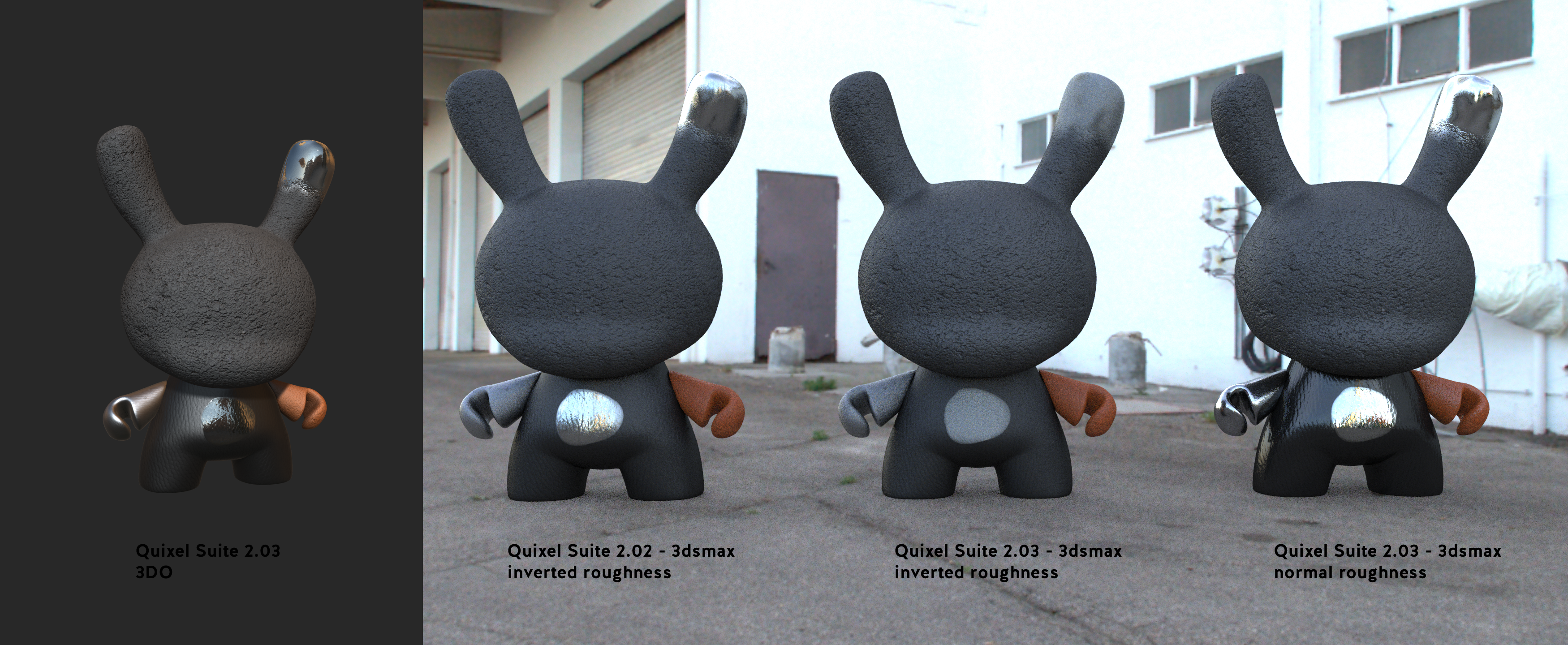

I have a problem now with the new Sepcualr workflow Octane (srgb) profile
it was kinda working in 2.02 (when they added the profile), i only had to invrt the roughness
but now in 2.03 (they fixed the naming of the maps - and something i dont understand) the roughness is off, inverting doesnt help and i cant imagine playing with the gamma would do any good.
GPU - 2x Gigabyte GTX1080 8GB + 1x EVGA GTX980 TI sc | CPU - Intel i7-4790K@ 4.0GHz | OS - Windows 10 Pro 64-bit - 32 GB RAM | 3Dsmax - many
Hi Pixonoid,pixonoid wrote:Hi,
how are you hooking your textures? are you building your own material?SRGB is not plug and play and unless you want to experiment I would advise against it.
i have added a MAX version of the PBR shader for Octane in the thread ,if all you want to do is work with the suite just use the Octane(Disney) profile in DDO load the textures in the shader and you should be good.

True, i just thought they made a specific profile to make it plug'n'play.miko3d wrote:Hi Pixonoid,pixonoid wrote:Hi,
Hope it helps
In 2.02 Quixel export of the Octane SRGB everything was kinda right, i only needed to invert the roughness ?
your shader is a big help and i use it. I'm just fiddle around with my workflow, that "monster" shader is kinda clunky in max.
i build my own mats all the time, i was just hoping that if they make a specualr octane profile and hand me albedo,spec,roughenss and normal
it wouldn't be neccesary to build up a huge colorcorrection, falloff, etc. material to get it right in octane.
